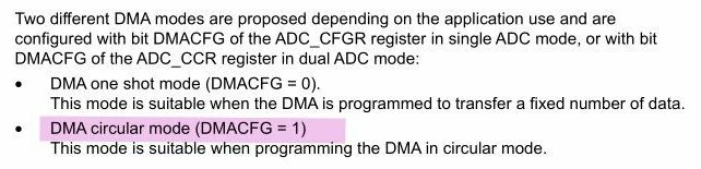

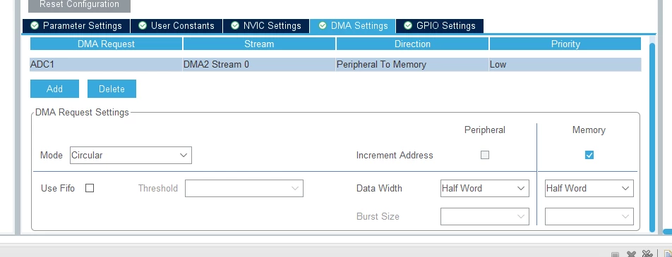

You need to set the DMA channel to "circular" mode in CubeMX. Did you?
"- If someone's post helped resolve your issue, please thank them by clicking ""Accept as Solution"".- Please post an update with details once you've solved your issue. Your experience may help others."
jwade19Author
July 5, 2024
Yes I did

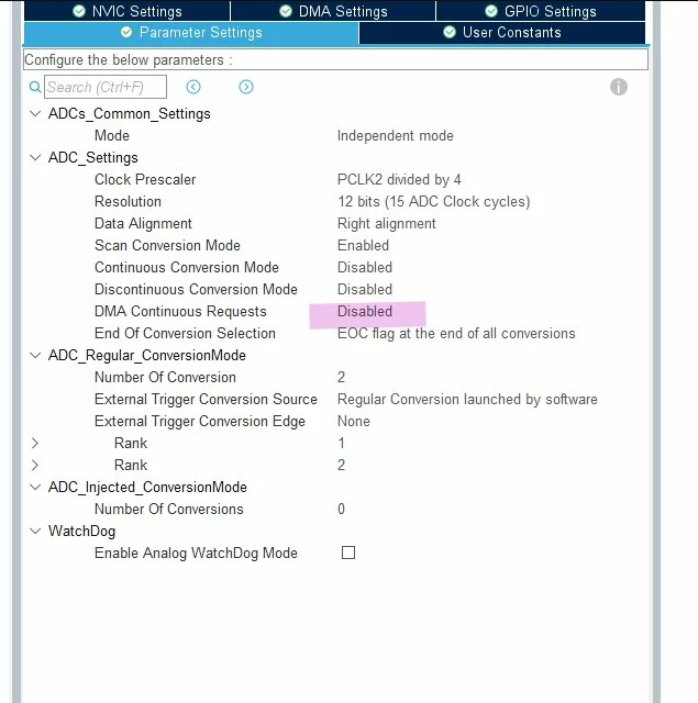

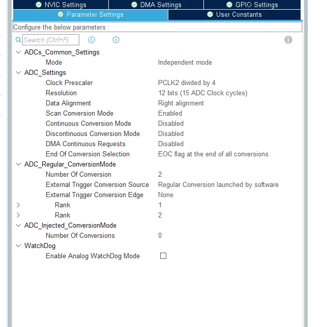

And I just included the DMA and Parameters sections as screenshots in original post.
jwade19Author
July 8, 2024
Sorry, that was indeed enabled, it was an old screenshot. Still not working

The chain of events looks something like this:
Trigger Conversion Start ->ADC start conversion->ADC conversion complete->ADC DMA request->DMA transfer.
You've set up the DMA to work in circular mode and told the ADC that the DMA is in circular mode, but what is triggering subsequent conversions? you either have to provide a periodic external trigger from another peripheral (such as a timer) to start conversions, periodically start an ADC conversion from software, or you need to configure the ADC to continuously perform conversions.
