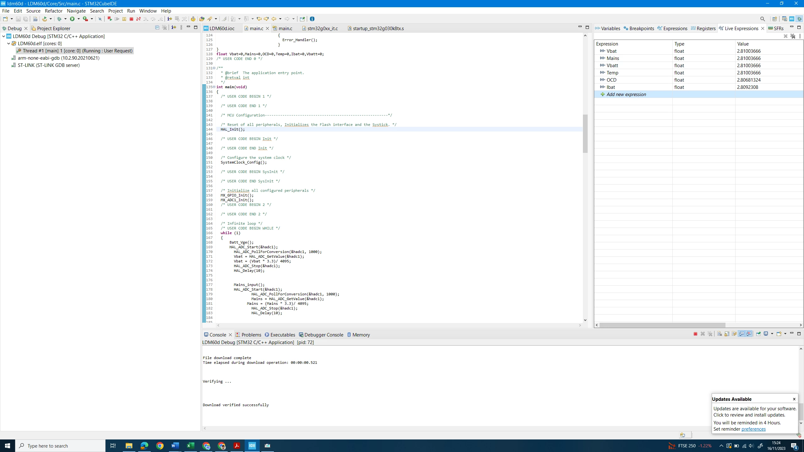

the code generated for my channels if i initialize this channels and
 hadc1.Instance = ADC1;
 hadc1.Init.ClockPrescaler = ADC_CLOCK_SYNC_PCLK_DIV2;
 hadc1.Init.Resolution = ADC_RESOLUTION_12B;
 hadc1.Init.DataAlign = ADC_DATAALIGN_RIGHT;
 hadc1.Init.ScanConvMode = ADC_SCAN_SEQ_FIXED;
 hadc1.Init.EOCSelection = ADC_EOC_SINGLE_CONV;
 hadc1.Init.LowPowerAutoWait = DISABLE;
 hadc1.Init.LowPowerAutoPowerOff = DISABLE;
 hadc1.Init.ContinuousConvMode = ENABLE;
 hadc1.Init.NbrOfConversion = 1;
 hadc1.Init.ExternalTrigConv = ADC_SOFTWARE_START;
 hadc1.Init.ExternalTrigConvEdge = ADC_EXTERNALTRIGCONVEDGE_NONE;
 hadc1.Init.DMAContinuousRequests = DISABLE;
 hadc1.Init.Overrun = ADC_OVR_DATA_PRESERVED;
 hadc1.Init.SamplingTimeCommon1 = ADC_SAMPLETIME_39CYCLES_5;
 hadc1.Init.OversamplingMode = DISABLE;
 hadc1.Init.TriggerFrequencyMode = ADC_TRIGGER_FREQ_HIGH;
 if (HAL_ADC_Init(&hadc1) != HAL_OK)
 Error_Handler();
 /** Configure Regular Channel
 sConfig.Channel = ADC_CHANNEL_0;
 sConfig.Rank = ADC_RANK_CHANNEL_NUMBER;
 if (HAL_ADC_ConfigChannel(&hadc1, &sConfig) != HAL_OK)
 Error_Handler();
 sConfig.Channel = ADC_CHANNEL_2;
 Error_Handler();
 sConfig.Channel = ADC_CHANNEL_5;
 Error_Handler();
 sConfig.Channel = ADC_CHANNEL_9;
 Error_Handler();
 sConfig.Channel = ADC_CHANNEL_15;
 Error_Handler();
 sConfig.Channel = ADC_CHANNEL_16;
 Error_Handler();
 /* USER CODE BEGIN ADC1_Init 2 */
 /* USER CODE END ADC1_Init 2 */
i am getting same value for all the adc value

Hello @meena,
Here some additional information :
  • HAL_ADC_ConfigChannel() configure a channel to be assigned to ADC group regular. That means you are configuring the channel every time you want to start conversions, that's a waste of time. You should configure once and if you want to update parameters on the fly without resetting the ADC, please use ADC_ChannelConfTypeDef().
  • You want to use the polling mode, you respected well the four points below :
    • Activate ADC peripheral and start conversions using function HAL_ADC_Start()
    • Wait for ADC conversion completion using function HAL_PollForConversion()
    • Retrieve conversion results using function HAL_ADC_GetValue()
    • Stop conversion and disable the ADC peripheral using function HAL_ADC_Stop()
  • But in the polling mode, you are polling the EOC (End Of Conversion) single flag configured with EOCSelection. You should set this parameter to ADC_EOC_SEQ_CONV and poll this flag to indicate the end of sequence conversions. If I understood your application, the best option for you is starting once the ADC, polling the right flag and then stop the ADC.
  • "ScanConvMode = ADC_SCAN_SEQ_FIXED" set to not fully configurable : number of ranks in the scan sequence is defined by number of channels set in the sequence, rank of each channel is fixed by channel HW number (channel 0 fixed on rank 0...). But you are affecting each rank to a channel as in the fully configurable mode (eg: channel 9 to rank 5). You may have to change that.
Best Regards,
Pierre

Hello @meena,
Thank you for your question!
Here some remark :
  • Do you know there are example code existing ? You can get software here (you can go under the root STM32Cube_FW_G0_V1.6.0\Projects\NUCLEOG071RB\Examples\ADC\ADC_MultiChannelSingleConversion).
  • Are you sure for NbrOfConversion = 1 ? You declared 6 regular channels right ?
  • For the overrun case, my advise is to use ADC_OVR_DATA_OVERWRITTEN.
  • Do you want to use the DMA feature with the ADC ?
  • I don't see any calibration before to start the ADC. You need to.
Best Regards,
Pierre

Thanks for the reply.This is what like I configured The no.of conversion made to 6 also getting same values
void ADC_Vbat(void)
	ADC_ChannelConfTypeDef sConfig = {0};
	 sConfig.Rank = ADC_REGULAR_RANK_1;
	sConfig.SamplingTime = ADC_SAMPLINGTIME_COMMON_1;
	 Error_Handler();
	 HAL_ADC_Start(&hadc1);
	 	 	 		HAL_ADC_PollForConversion(&hadc1, 1000);
	 	 	 		Vbat = HAL_ADC_GetValue(&hadc1);
	 	 	 		//Vbat = (Vbat * 3.3)/ 4095;
	 	 	 		HAL_ADC_Stop(&hadc1);
void ADC_BattIsense(void)
	 sConfig.Channel = ADC_CHANNEL_3;
	 sConfig.Rank = ADC_REGULAR_RANK_2;
	 Error_Handler();
	 	 	 	 		BattI = HAL_ADC_GetValue(&hadc1);
void ADC_ledIsense(void)
		 sConfig.Rank = ADC_REGULAR_RANK_3;
		 Error_Handler();
		 	 	 	 		LedI = HAL_ADC_GetValue(&hadc1);
void ADC_Temp(void)
	 sConfig.Rank = ADC_REGULAR_RANK_4;
	 Error_Handler();
	 		 	 	 	 		Temp = HAL_ADC_GetValue(&hadc1);
void Open_Circuit(void)
	 sConfig.Rank = ADC_REGULAR_RANK_5;
	 sConfig.SamplingTime = ADC_SAMPLINGTIME_COMMON_2;
	 Error_Handler();
	 	 		 	 	 	 		Opv = HAL_ADC_GetValue(&hadc1);
