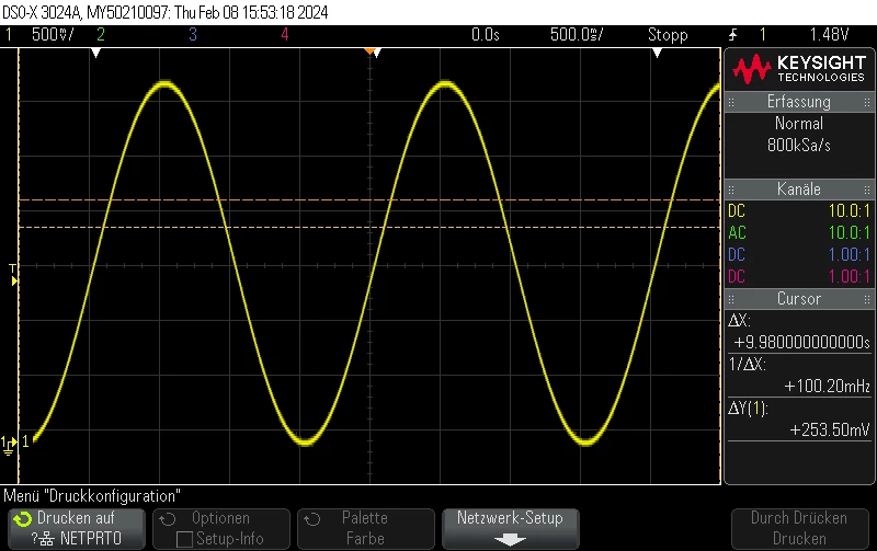

Test 1:
apply a 200mHz sine-wave directly to the button pin. Expected behavior is: one interrupt on rising one interrupt on falling signal (due to the 200mV hysteresis on every input pin, as mentioned in datasheet). Behavior in RealLife: as soon as the voltage level on the pin reaches the switching thresholds of the input pin, i get lots of Interrupts (Rising and falling edge).
BUT now its getting freaky: if i turn off the running FMC access to an external RAM, instantly everything works as expected - only one single interrupt per transition.

So as you can see, in the phase without FMC-RAM-Access the pin changes approx. every second, as expected, but if there are FMC-RAM Accesses the pin do whatever it wants. And there are unwanted pin changes.

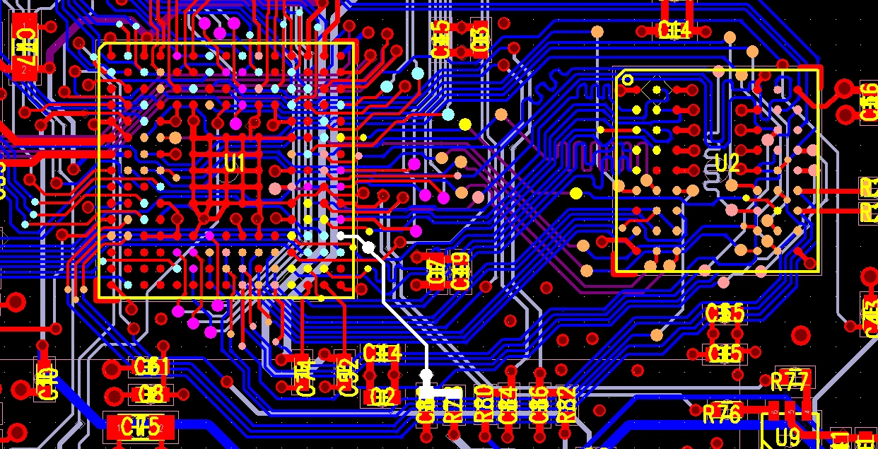

Are all of the power pins decoupled with a 0.1 uF close to the chip? Can you share a photo or schematic?
Are the misbehaving EXTI traces in close proximity to FMC traces?

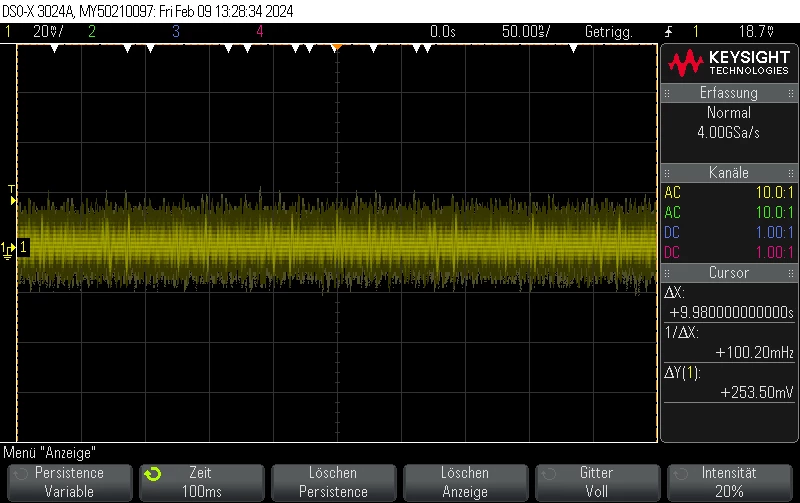

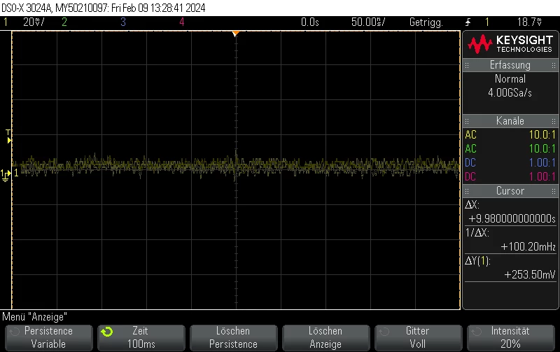

the white one is one of the affected EXTI-Pins. The other chip on the right side, is the RAM. In my opinion there cannot be lot of interference by the FMC-Traces.
I checked the trace with my scope, measured the testpoint directly near at the STM.
scope_4.pngfor sure, this picture is very low horizontal resolution, but also in other resolution, there are no glitches or noise present on this trace.

Your PCB screenshot looks quite good and professional, but there are many close copper traces, so I can imagine there could be some crosstalk. Especially if the debouncing Rs & Cs are close to the buttons (where they should be), but the deciding factor might be what's happening at the MCU pin (maybe try some stronger / weaker external pull-ups).
Just to make sure, every pcb signal layer has a neighbouring low impedance plane layer connected to ground or VCC? No gaps in the planes?
Until now I have used quite a few ST test boards, incl. Nucleo-H723 and H735-disco, I never had these problems, and some of the boards have a terrible layout (due to the fact that a Nucleo's pins have many options), and my firmware did quite some stuff (ETH, OSPI HyperRam, SAI, I2S).
Have you checked that you are not double-using some EXTI / FMC pins?
I cannot imagine that this is a STM32 problem. But who knows...

thank you for your valuable input. Crosstalk from other pins was also one of my attempts so i used my (of course not the fastest one) to inspect the problem-trace.
Coupling was AC to filter the DC-part and to bring the signal down to GND, for better scoping. GND-Spring to have lowest possible GND-Loop (only few mm) to reduce extra noise due to the scope probe. And i scoped the via, directly near to the BGA, not to miss anything.
first one is without FMC-communication
second one with running FMC-communication (Be careful, it looks worse than it is due to the "Persistance-overlay" view of the scope.)
so, of course the noise level rises, but all within +/-20mV compared to the 200mV pin-hysteresis, i would say, this can not be the cause. It should be an easy one for the Schmitt trigger to filter this small noise.
