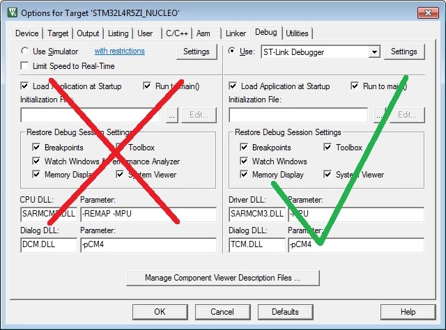

>>How could I solve these issues
STOP using the Simulator, all the ERROR 65 posts are from people trying to use the simulator which doesn't support their hardware. Keil has stopped supporting simulations of the 1000's, and growing, chips from everyone and their brother, NUCLEO and DISCO boards are now very cheap and have an on-board debugger. If you want to simulate the Cortex-M4 core you can probably do that, but once you start touching peripherals added by the vendor you will get this error.
Use Real Hardware
Use the Debugger, NOT the Simulator

>>Google keil initialization file. Essentially you need to mark certain memory regions read write or execute-able.
This allows code to plough forward in the simulator but doesn't make the underlying 'memory' function like the peripherals the code is expecting.
The solution here is not to hammer harder, but to stop hammering.
