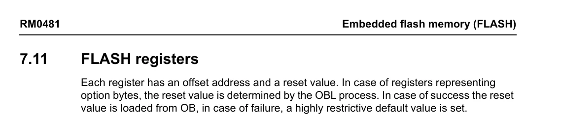

・According to the reference manual, the factory default value for FLASH_OPTSR2_CUR is 0xB400_170, with TZEN[7:0] set to 0xB4, meaning TrustZone is enabled.
 However, when I read FLASH_OPTSR2_CUR from a microcontroller in its factory-shipped state, the value was 0xC300_017C, with TZEN[7:0] set to 0xC3, meaning TrustZone is disabled.
 Is the default value stated in the reference manual incorrect?

After checking internally, the default value of FLASH_OPTSR2_CUR register is the value forced into the register if the OBL fails.
Thank you.
