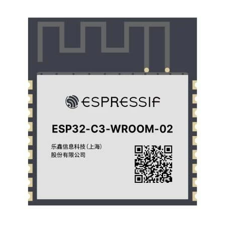

Apparently there was a mix-up between the ESP32-C3 and the STM32.
Being ESP32, it's another forum: https://www.esp32.com/
ESP32-C3-WROOM-02_SPL
