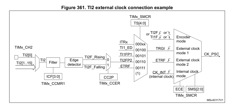

>Good catch!
Yes - but still some delay... -> see Tim input circuit:
+ the inputs need to be sync to internal clock , so they go to one or two flip-flops first, to be sync .
All this running on the timer clock...so at first: higher clock -> less "delay" (for symc circuit).
Then Filter : off.  (delay much more, depending on setting).
Then...maybe shortest, you can get this way.
+ Some "sync circuit" you have on all inputs, that come to the internal circuits, to avoid race conditions.
If you need the pulse without any delay, use a simple external gate; maybe controlled by a cpu pin, to en-/disable it.

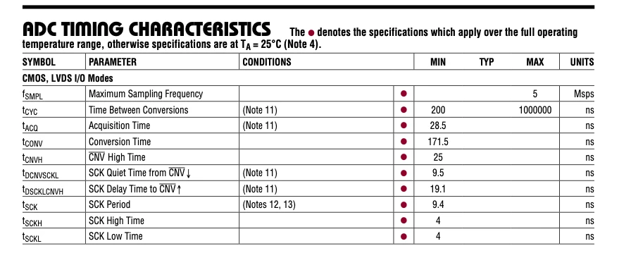

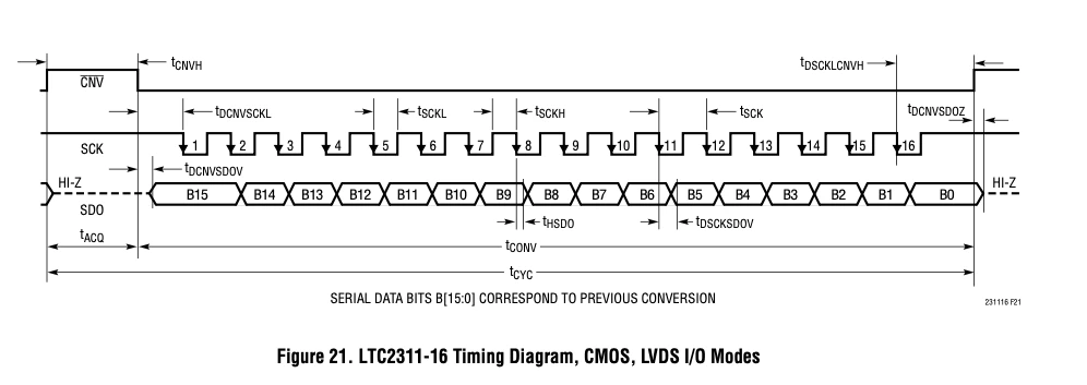

This entire exercise started because once turned on and free running, the STM32 SPI peripheral HW timing at 100MHz does satisfy the requirements of a chip we are using.
The tdcnvsckl at 100MHZ is ~ 6ns and can't be modified in the STM32 SPI peripheral.  So the idea was to increase the SPI_CS CNV, MIDI[3:0]: master Inter-Data Idleness time a little, then use that to trigger a smaller pulse.  But 26-60ns lag time won't work.
marker 0:0, = 6ns
