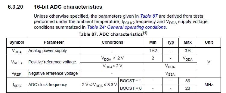

    The datasheets says (P173) - the VREF– s available only on UFBGA176+25 and
TFBGA240+25. When VREF- is not available, it is internally connected to VDDA and VSSA.
 Our ADC input signal goes to both positive and negative.

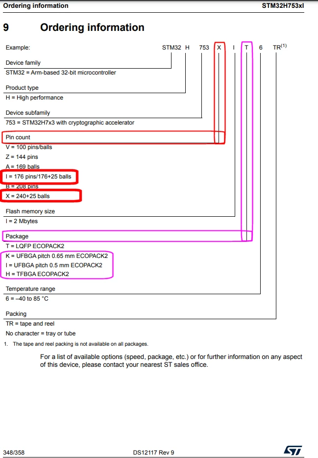

1. What the part number we should use, which allows VREF–? (Negative ref)

refer to chapter 6.3.20 of datasheet

Refer to chapter 9 Ordering information, for part number with VREF-

"Refer to chapter 9" - In which document?
Thanks again
jiangfan
November 21, 2024
datasheet

VREF+ max is Vdda (Max 3.6V), so, I suppose VREF- min is -3.6V

“VREF+ max is Vdda (Max 3.6V), so, I suppose VREF- min is -3.6V”
What is VREF+ min ?
What is VREF- max?

if understand correctly, NUCLEO-H753ZI board does not support negative ADC input if ADC input directly connected to STM32H753ZI pin. User may use OPAMP to shift negative input ~ positive input => 0 ~ Vdda, for example -5V ~ +5V => 0V ~ 3.3V.

   The datasheets (STM32H753ZI) says (P173) - the VREF– s available only on UFBGA176+25 and
TFBGA240+25.
    Should we specify it when order (STM32H753ZI)?

The package type & number of pins is part of the ordering code:
https://www.st.com/resource/en/datasheet/stm32h753zi.pdf#page=348
