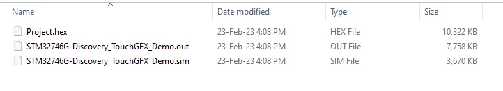

I want STM32746G-DISCO_Demo_V1.7.0.hex file can anyone tell me how to get that?

Hello @SNC.1​ ,
Please you can refer to the projects in the Cube FW V1.17.0 for example:
STM32Cube_FW_F7_V1.17.0\Projects\STM32746G-Discovery\Demonstrations\TouchGFX\EWARM\STM32746G-Discovery\Exe
Foued

Sir,there is no exe file in that path

Make sure that you are using Cube FW V1.17.0 version.
