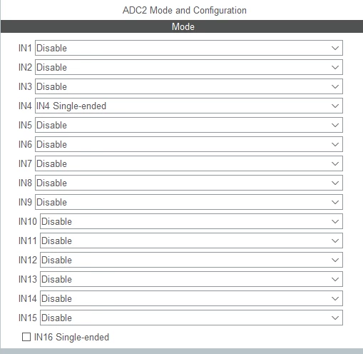

Hello.​
I am using the STM32L4 series.
I want to send the ADC converted sensor value to the PC via UART communication.
I started ADC in /* USER CODE BEGIN 2 */ zone of "main.c" output from CubeIDE, but it failed.
When the start instruction is given twice as shown below, the code is executed, but the sensor value cannot be obtained.
if(HAL_ADC_Start_IT(&hadc2)!=HAL_OK){ //result: TRUE
int aaa=0;
aaa=1;
if(HAL_ADC_Start_IT(&hadc2)!=HAL_OK){ //result: FALSE...why?
aaa=0;
I am at a loss because I have no idea what the cause is.
I am sorry to trouble you, but please reply regarding this matter.

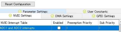

If the result is not HAL_OK, find out what it is. And/or debug-step into the second call. HAL_ADC_Start_IT - do you have interrupt enabled and a callback?

I'll try check the details of the result.
I have enabled ADC2, but not specifically enabled interrupts (see image).
​I am thinking to enable continuous conversion and get the value as below with timer interrupt.

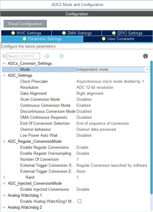

The ADC is set to continuous conversion mode. Need to care about the timing of the process?
The ADC value is obtained in the timer interrupt process.
iAdVal=HAL_ADC_GetValue(&hadc2);

MM..1
August 22, 2020
When you start IT version then ADC runs on background. Your code continues immediately to next start end return false = cant start twice.
Plus continuos mode dont need next start without any stop used.
waclawek.jan
August 22, 2020
Then why do you start it the second time?
MM..1
August 22, 2020
When parenthes in code is ok second start never occur when first is true, But if example code is repeated then both results is false,..
