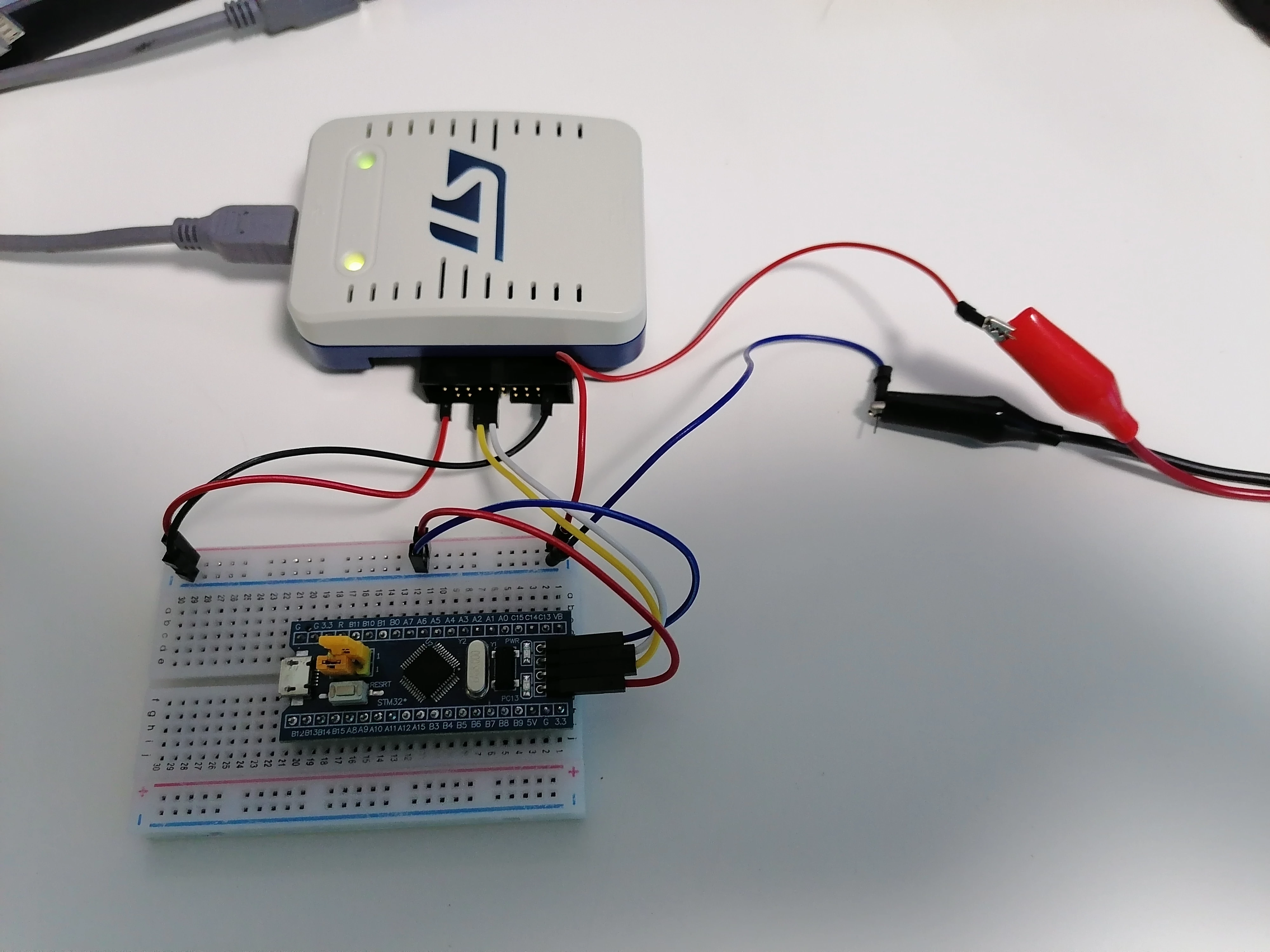

1. Here is the pins connection layout using CN2 JTAG:
+5V external ----> T_VCC pin 1
GND ---------------> GND pin 20
SWDIO ------------> T_SWDIO pin 7
SWCLK ------------> T_SWCLK pin 9
The actual connection is like below:

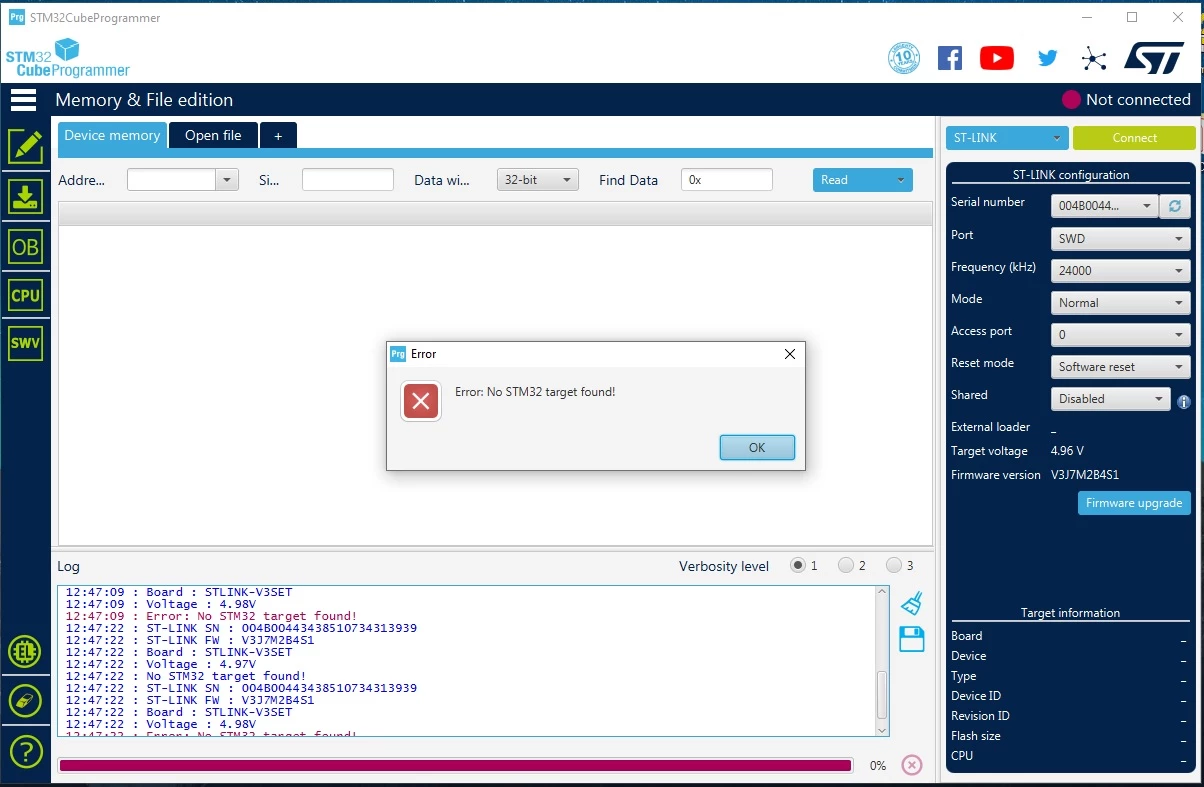

STM32CubeProgrammer already upgraded to latest ST-LINK V3SET firmware V3.J7.M2.B4.S1,
but I am unable establish connection to the STM32F103C8T6 board as shown picture below and the STM32CubeProgrammer CANNOT BE CLOSED:
I have reset by pressing the RESET button ( Software/Hardware reset options selected ) then followed by clicking the Connect button, the result still the same as shown above, any idea ?
My new ordered Nucleo F103RB board is on its way, but now I just wanted to test the STM32F103C8T6 clone board which is very common.
Please advise if there is any error connection above, I am new to ST-LINK V3SET.

    VTarget of 5V is clearly inappropriate, thing should be running at 3 or 3.3V

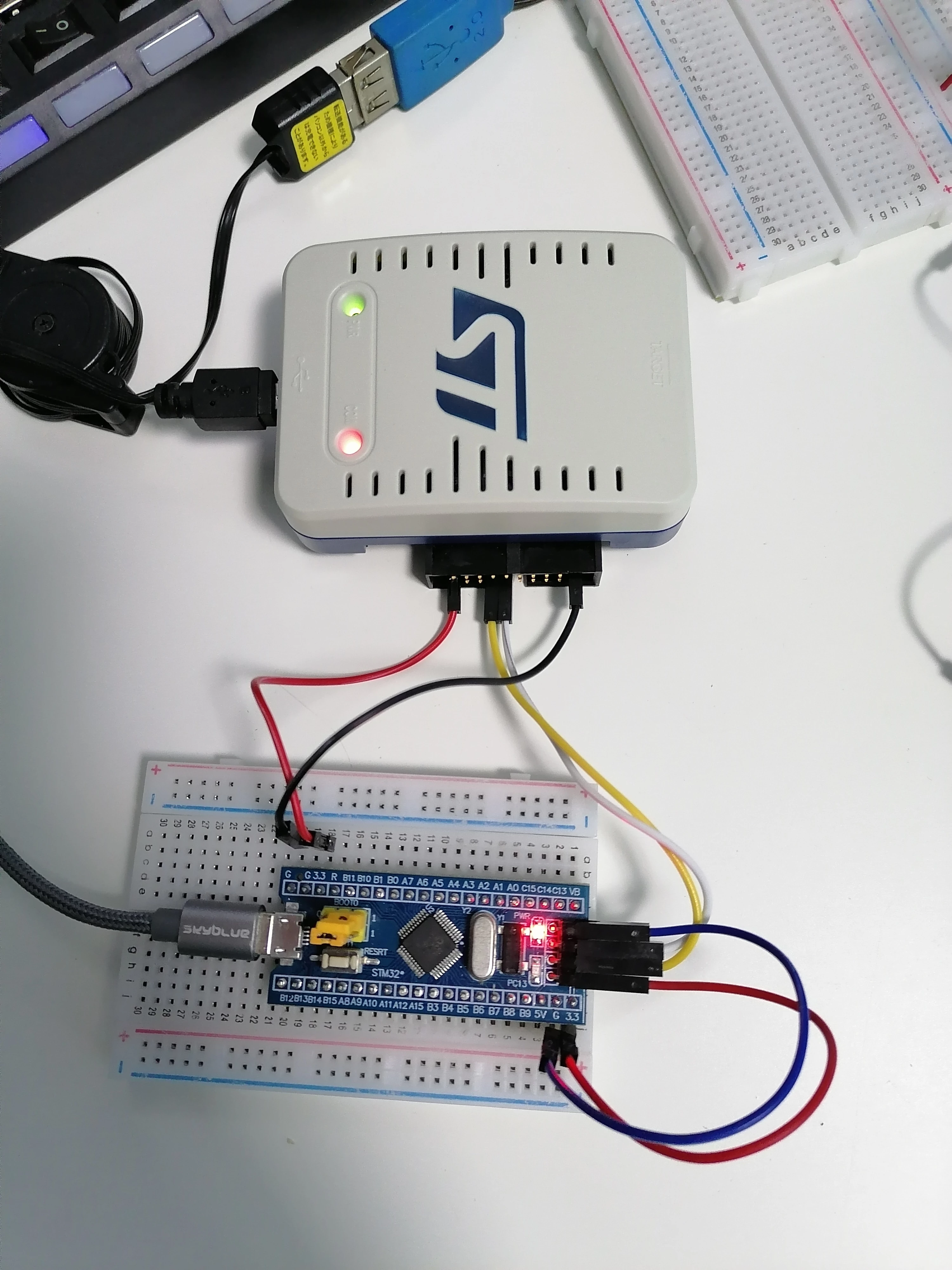

    Tesla DeLorean
    Guru
    February 23, 2021
    https://stm32-base.org/boards/STM32F103C8T6-Blue-Pill.html
    There should be a 5V supply pin you can use on the board. Connect that up, and then the Pin 1 of the SWD header should be at 3V3, and you can use that as VTarget (Pin 1 JTAG)
    Ricky Gai
    Ricky GaiAuthor
    February 23, 2021

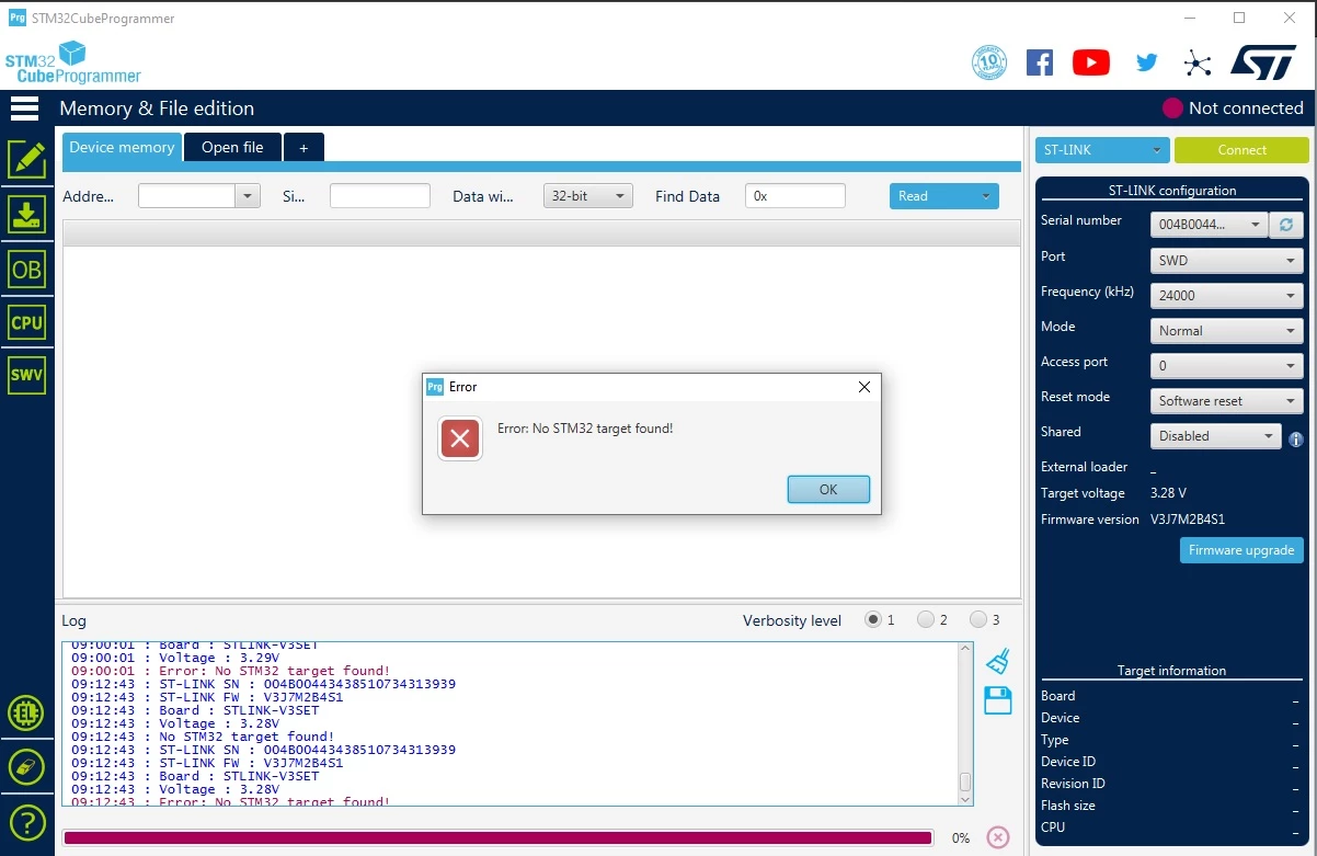

    • The VTarget (pin 1 JTAG) based on datasheet is input voltage right ? I did connected the STM32F103C8T6 SWD 3.3V pin to T_VCC pin 1 JTAG and GND to pin 20 JTAG before, the STM32F103C8T6 cannot be powered up and result still the same.
    • The +5V output pin of STM32F103C8T6 is none regulated, in fact I just used USB to powered the STM32F103C8T6 like picture below:
    However, the result still the same unable to establish connection between STM32CubeProgrammer and the STM32F103C8T6 clone board and the STM32CubeProgrammer CANNOT BE CLOSED.

    Bluepils often have STM32F103 clones. StlinkV3 denies active to work with those parts.
    Ricky Gai
    Ricky GaiAuthor
    February 23, 2021
    hi Uwe Bonnes, thank you for the feedback, I just received information from "S C ( ST Employee )", the support also said so, it could be clone STM32F103 is not supported by STLINK V3.
