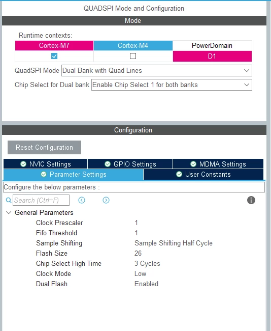

Hi I am testing a STM32H745I-DISCO
I am setting QSPI from ioc file by referring to the example code provided by ST
Below is the example qspi configuration code
  QSPIHandle.Instance = QUADSPI;
  /* QSPI initialization */
  /* ClockPrescaler set to 1, so QSPI clock = 200MHz / (1+1) = 100MHz */
  QSPIHandle.Init.ClockPrescaler   = 1;
  QSPIHandle.Init.FifoThreshold   = 1;
  QSPIHandle.Init.SampleShifting   = QSPI_SAMPLE_SHIFTING_HALFCYCLE;
  QSPIHandle.Init.FlashSize     = QSPI_FLASH_SIZE;
  QSPIHandle.Init.ChipSelectHighTime = QSPI_CS_HIGH_TIME_3_CYCLE;
  QSPIHandle.Init.ClockMode     = QSPI_CLOCK_MODE_0;
  QSPIHandle.Init.FlashID      = QSPI_FLASH_ID_2;
  QSPIHandle.Init.DualFlash     = QSPI_DUALFLASH_ENABLE;
  sCommand.InstructionMode  = QSPI_INSTRUCTION_1_LINE;
  sCommand.AddressSize    = QSPI_ADDRESS_32_BITS;
  sCommand.AlternateByteMode = QSPI_ALTERNATE_BYTES_NONE;
  sCommand.DdrMode      = QSPI_DDR_MODE_DISABLE;
  sCommand.DdrHoldHalfCycle = QSPI_DDR_HHC_ANALOG_DELAY;
  sCommand.SIOOMode     = QSPI_SIOO_INST_EVERY_CMD;
Below is a picture of how I set the parameter values ​​in the ioc file
0693W00000YAh2kQAD.pngParameter values ​​that configure QSPIHandle exist in the ioc file. However, the parameter values ​​that set sCommand are not visible in the ioc file.
How should I set the parameter values ​​of sCommand in the ioc file?
