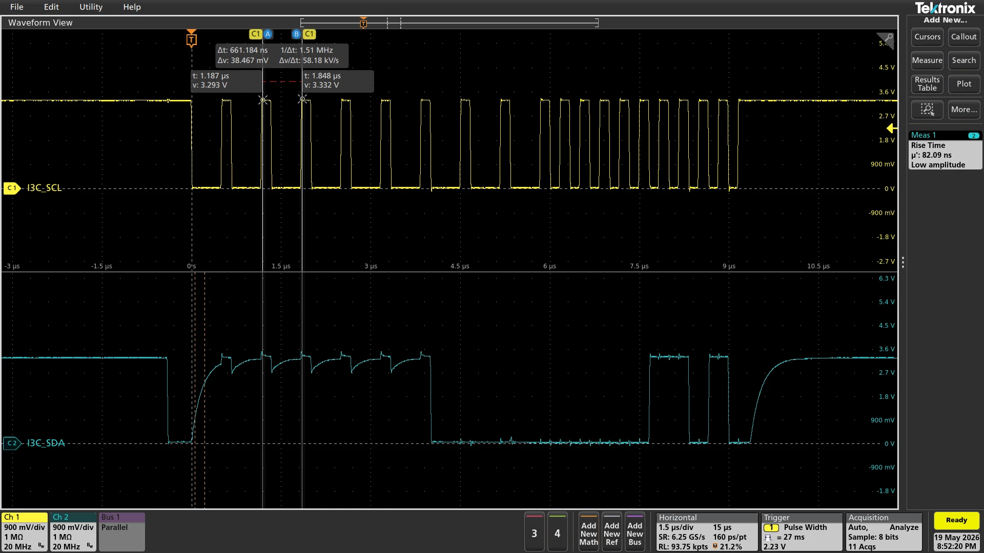

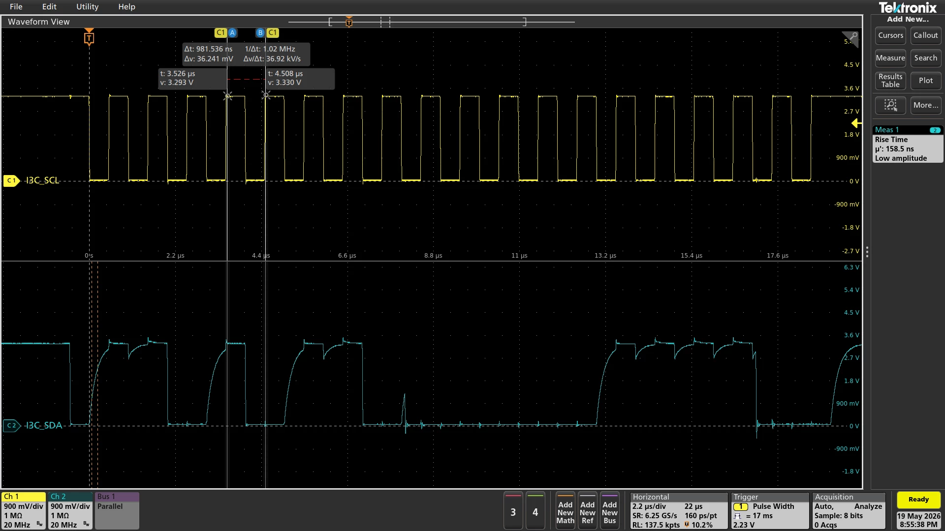

I am working on a NUCLEO-H503RB board and communicating with two LSM6DSO devices over an I3C bus operating in I2C Mixed Mode.
When the bus is running in Open-Drain mode, I observe the following waveform characteristics on the SDA line:
  1. When SCL transitions from High to Low, SDA exhibits a momentary voltage drop.
  2. During the SDA pull-up (charging) phase, the signal does not follow a smooth RC charging curve. Instead, it initially rises slowly and then suddenly jumps to a higher voltage level (VH).
SDA waveform during I3C communication
SDA waveform during I2C communication (Open-Drain mode)
Could anyone help explain the possible causes of these behaviors? Are they related to I3C/I2C bus characteristics, device handoff timing, pull-up configuration, parasitic capacitance, or measurement effects?
Any suggestions or insights would be greatly appreciated.
Thank you.

What pull-up resistors value you set for SDA and SCL?
jad1Author

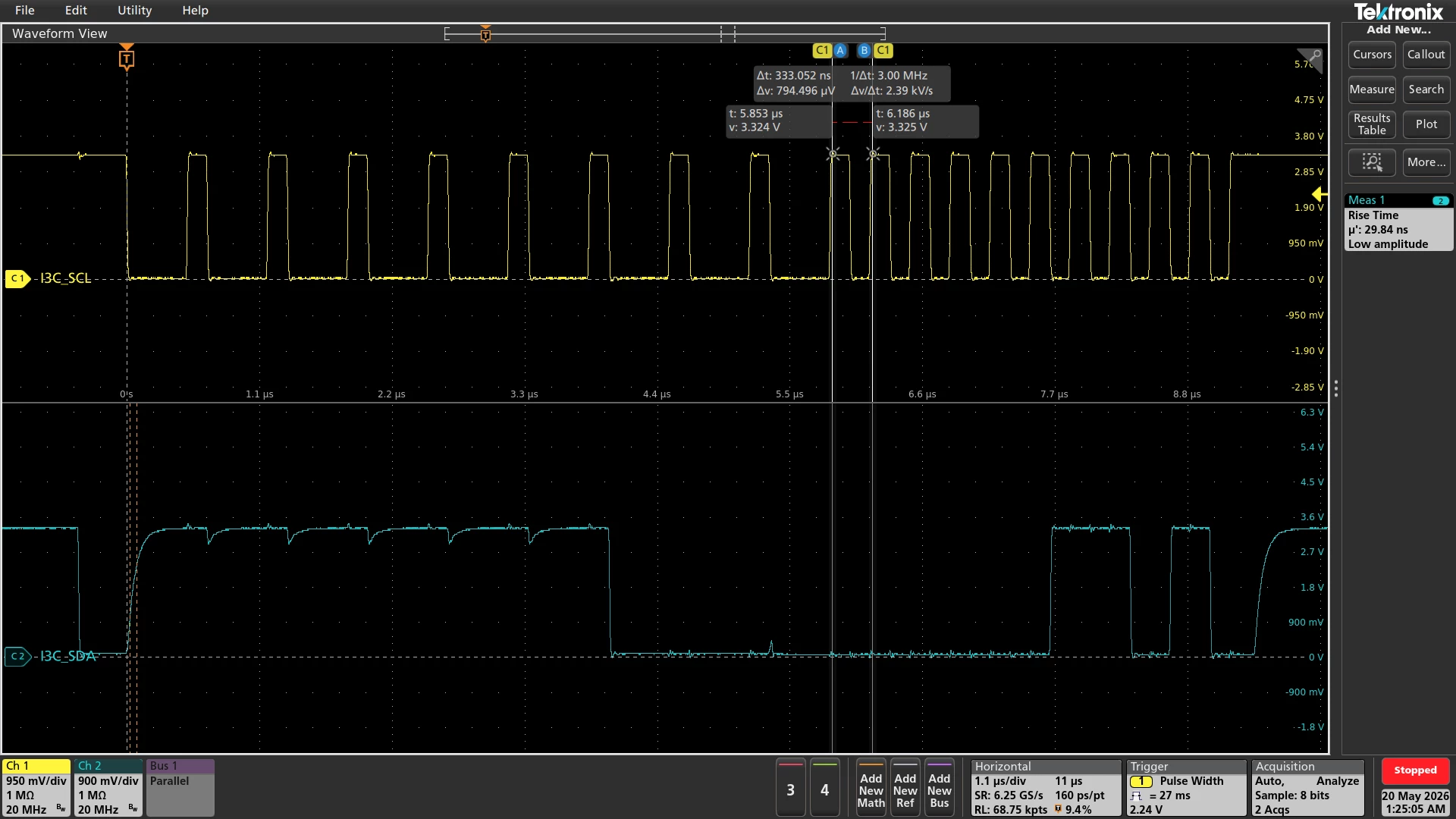

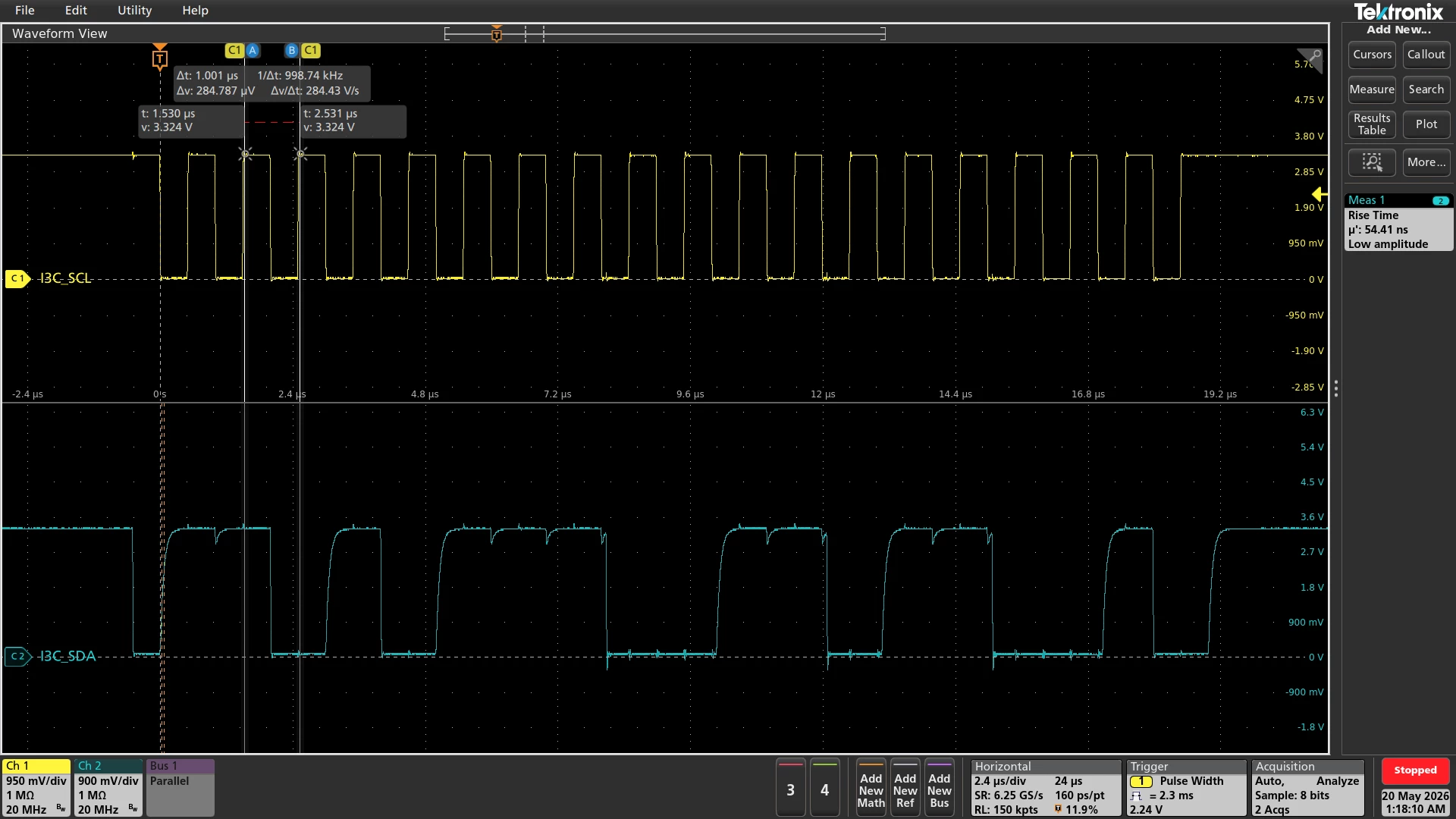

Jul 2, 2026 1:18 AM UTC
There are no external pull-up resistors on the bus. After adding a 2.2 kΩ pull-up resistor to SDA, I still observe the same behavior: SDA exhibits a brief voltage dip when SCL falls from High to Low, as shown below.
