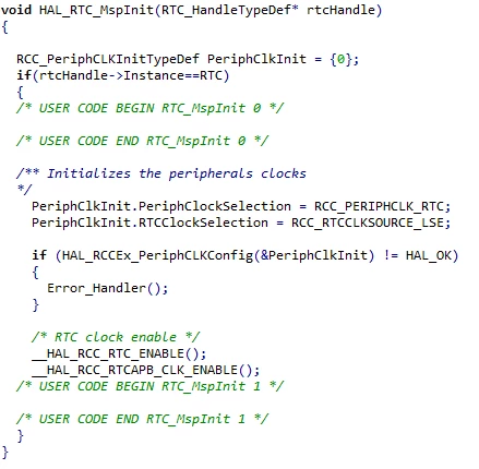

Stassen.C
August 10, 2023
J_m,
That should do it, just check that in the HAL_RTC_MspInit the clock selection is also LSE.
Regards,
Stassen
j_mAuthor
August 14, 2023
Thank you very much.
I can confirm that the RTC is updated.
