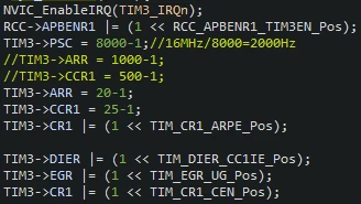

I want to perform a timer interrupt using the output comparison mode.
When the frequency is set to 2000Hz, ARR : 20, CCR1 : 25, I think that interrupt does not occur because ARR <CCR1, but interrupt occurs. Why do interrupts occur?
Best answer by waclawek.jan
This is a documented behaviour of the timer.
http://www.efton.sk/STM32/gotcha/g31.html
JW​
JW​

I confirmed that it is described in the reference manual.
I overlooked it because it was not mentioned in the Japanese version of the manual.
