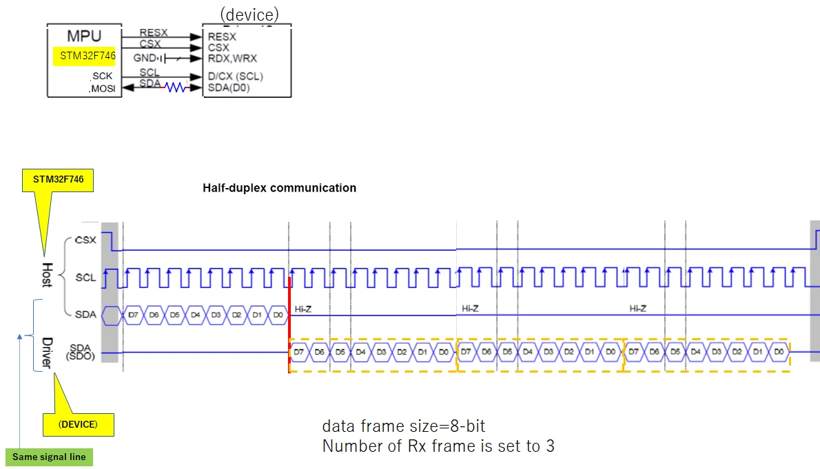

Is it possible to perform half-duplex communication like the attached document?
 (I understand that the timing to switch to Rx is tricky.)
The Rx frame size is 3 instead of 1.
After changing to Rx, can I receive 3 bytes continuously as shown in the figure?
In that case, should I use RXFIFO?
Is it possible to select only 8-bit or 16-bit data size for the FIFO?
