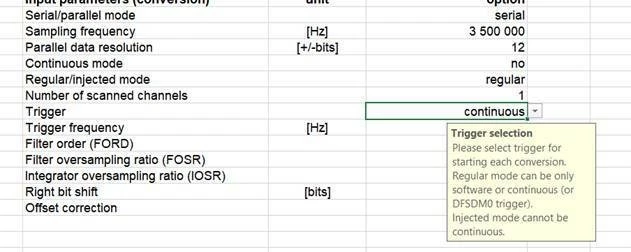

I have a question about the tutorial for the DFSDM excel file.
https://www.st.com/content/ccc/resource/technical/document/technical_article/group0/1b/40/1d/43/1b/8d/47/65/dfsdm_tutorial/files/dfsdm_tutorial.xlsx/jcr:content/translations/en.dfsdm_tutorial.xlsx
In the "DFSDM configurator" sheet, what the "Sampling frequency" on B6 cell means?
I am setting the clock frequency (2~3.25MHz for MEMS mic) and results similar sampling rate with actual data plot.
I'd like to make sure I understand the parameter correctly.
Thanks in advance.

Hi @marchalloakbow​ ,
Sorry for the delayed reply on this.
The “sampling frequency�? means the input serial clock – rate at which is the serial data provided from the sigma-delta modulator.
Each parameter has in XLS some hint – to show explanation. For example:

Hello @marchalloakbow​ ,
You should make sure to select right Trigger slection.
Which mode are you using (Serial/parallel mode) ?
Please share your paramater setting for check your use case.
Imen

Hello Ms. Imen​, thank you for your comment.
I am using Serial mode, and Trigger selection is continuous, 64000 Hz.
Besides the question above, I'd like to know where to read to understand these trigger setting.
