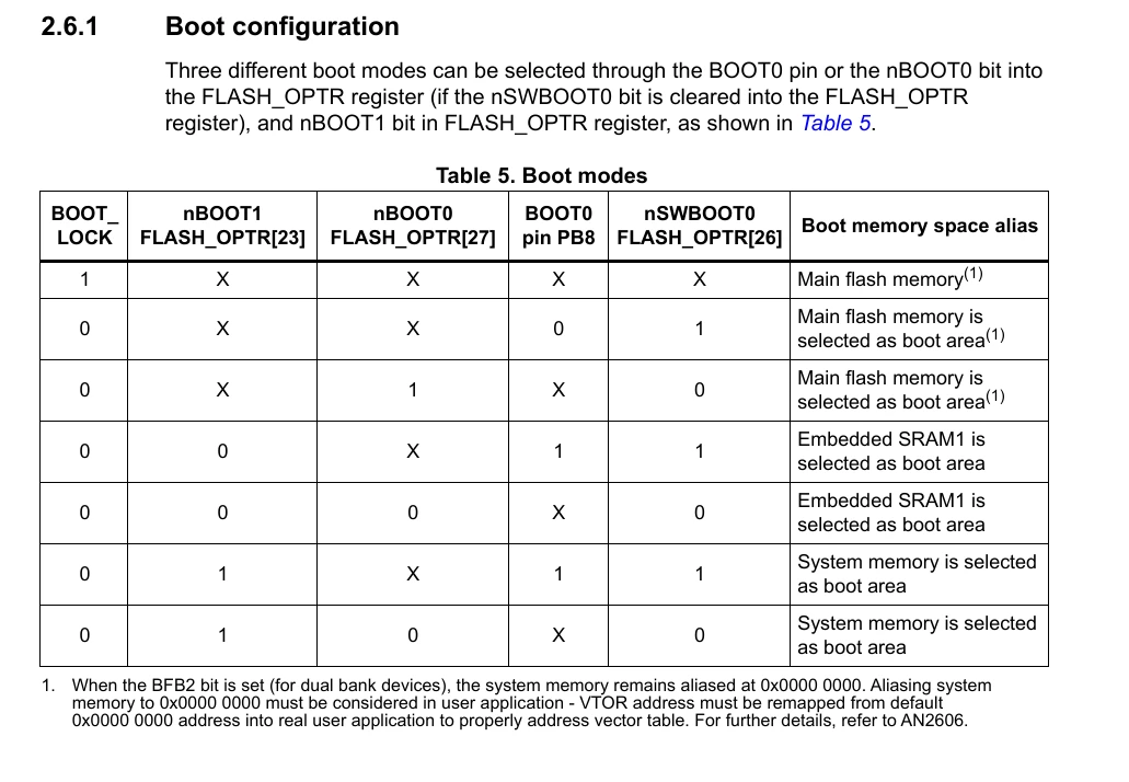

About BOOT0 and BOOT1 pins on STM32G474R ?

  1. The STM32G474R datasheet does not mention the BOOT1 pin.
  2. If the BOOT0 pin of STM32G474R is set to high, where does the program start?
  3. If the BOOT0 pin is set to high and the BOOT1 pin is set to high, the program starts from SRAM. Is the program size limited by the size of SRAM? If a bootloader program and a main program are written, with the bootloader starting at address 0x20000000 and the main program starting at address 0x08000000, can this solve the issue of jumping from SRAM at 0x20000000 to flash memory at 0x08000000, so that the main program size is only limited by the size of flash memory?

Hello @halfhalf
On STM32G474R, there is no BOOT1 pin. With the default configuration, BOOT0 = 1 boots to system memory (the ST ROM bootloader), not to SRAM. If code is executed from SRAM, then its size is indeed limited by the available SRAM, but you can still have a small SRAM-resident routine or loader jump to an application stored in Flash at 0x08000000; in that case, the main application size is limited by Flash, not SRAM. However, for a real product, the usual and recommended approach is to place both the bootloader and the application in Flash, because SRAM is volatile and does not retain code after reset or power-off.

Shirley.Ye
Apr 27, 2026 3:26 AM UTC
you can check the STM32G474R reference manual, there is no boot1 pin, but nSWBOOT0, nBoot0, nBoot1.
if the Boot0 s high,  and
Shirley.Ye
Apr 27, 2026 3:28 AM UTC
if the Boot0 s high,  and nswboot0 is 1, you need to check also the nboot1 value
