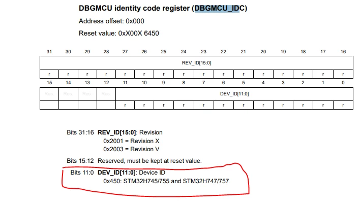

yuri CH
yuri CHAuthor
Senior
May 30, 2023
thanks for your response,
had a look in the reference manual
_legacyfs_online_stmicro_images_0693W00000bl91jQAA.pngas i understand this register will not distinguish between those specifdic two (stm32h757 and stm32h747). correct me if i am wrong please...
May 30, 2023
Hello again @yuri CH​,
Thank you for your feedback. You can check if the crypto is enabled.
Would you please read memory directly starting from this address 0x1FF1E8C0 and tell us what you can see?
