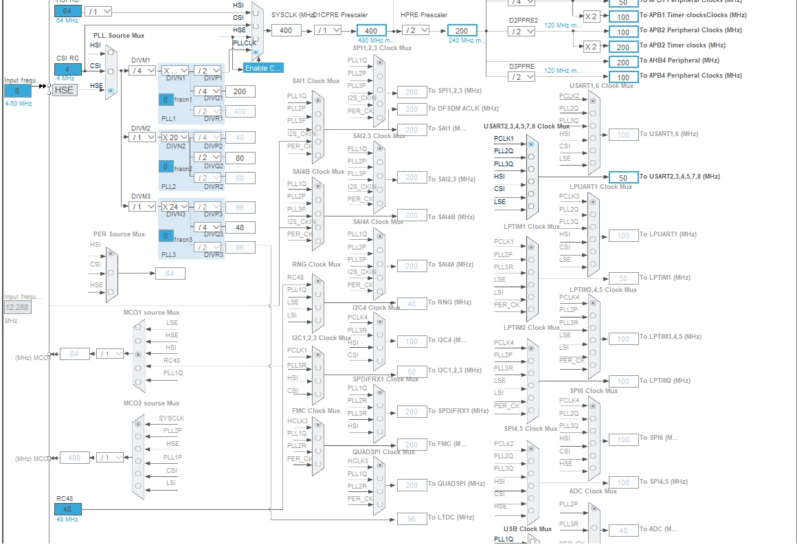

0693W00000Kd60AQAR.png]Hello,
I have updated STMCubeIDE to version 1.9.0
and Imported .ioc file created in version 1.8.0.
Created the project again.
Comparing source code
PeriphCommonClock_Config() is no longer generated in Ver1.9.0
No clock is provided to the ADC module
This is probably the cause of the ADC calibration failure
When ADC1 is selected, the ADC clock is grayed out in the Clock Configuration tab

I tried and error this issue in STMCUbeIDE1.9.0.
However, no solution was found
The current solution is to use Ver1.8.0.
