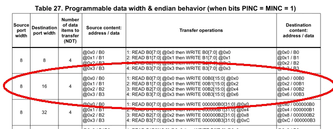

I'd expect 8-bit memory read and 16-bit peripheral write to behave in a predictable way. Perhaps not the way you want.
waclawek.jan
September 18, 2017
Posted on September 18, 2017 at 12:34
There are basically two ditinct DMAs in the STM32 (the OP didn't care to tell us the model he is using):
In the simpler one used in 'F0/'F3/'Lx , in this case the controller expands the upper 8 bits by 0.
In the complex dual-port  DMA ('F2/F4/F7), there is a FIFO inserted into the data path. If FIFO is not used (aka Direct mode) such transfer is impossible, as in that case the memory-side width-setting is ignored. If FIFO is used, the controller always reads at least 4 bytes into FIFO (bytewise if set so) and then writes the concatenated result halfword-wise into the peripheral port.
Neither case fits OP's need.
[rant mode on] Adult UARTs either have dedicated addressed (Intel-originated) mode, or parity settable [also] to MARK/SPACE. Pity the STM32 peripherals were/are designed by staff inexperienced in making practical applications. IMO it wouldn't be that hard nor silicon-consuming to design STM32 UARTs to be register- and functionally compatible with existing industry-standard UARTs, which would help avoid already explored pitfalls, increase functional compatibility and facilitate their usage and code reuse too. [rant mode off]

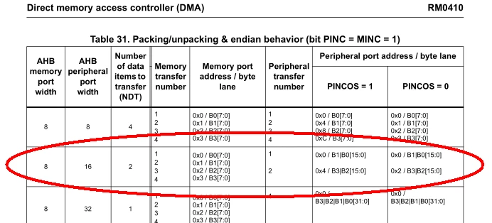

I'm using the USART2 the STM32F334xx in 9-bit mode (multiprocessor communication as said in the reference manual) for "Address Mark detection". I populate a 16 bits buffer with first the address (0x01XX) and then the data (N x 0x00YY). It works well manually doing this in a loop:
uint16_t usartCharSendBuffer[128];
... populating the frame in usartCharSendBuffer[]
loop on (with while (!LL_USART_IsActiveFlag_TXE(USARTXX)) {} or IRQ)
 LL_USART_TransmitData9(USARTXX, usartCharSendBuffer[idx_send++]);
I want to use the DMA to minimize the IT requests but I have the similar issue as @Community member​ (but I want to have a 16 bits buffer) : whatever data size I set for the memory and the peripheral's sides, the bit 0 of TDR is reflected into bit 8. It acts as the TDR forces the DMA to work with the LL_DMA_MDATAALIGN_BYTE option. Despite I set:
 dma.MemoryOrM2MDstDataSize = LL_DMA_MDATAALIGN_HALFWORD;
 dma.PeriphOrM2MSrcDataSize = LL_DMA_MDATAALIGN_HALFWORD;
Reference manual says:
• To write the halfword “0xABCD�?, the DMA sets the HWDATA bus to “0xABCDABCD�?
with HSIZE = HalfWord
• To write the byte “0xAB�?, the DMA sets the HWDATA bus to “0xABABABAB�? with
HSIZE = Byte
Does someone know if I missed a setting or if it is a limitation of the STM32F334xx's UART?
