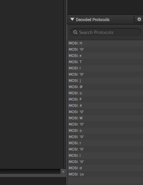

Using STM32F767 Nucleo board and STMCubeIDE I am trying to transmit SPI data with data size of 8bit per transaction while I have setup my SPI2 in Full Duplex mode.
Problem is that although I am able to transmit from MCU and receive on slave side the data whatever I am trying to send that is "Hello World" message for a test. But with each byte I get one random data byte then the right data byte again as shown in attached screen shot decoded on Logic Analyzer.
As I am trying to send 8 bit data while SPI_DR (data register ) is mapped as 32bit in register structure for SPI while only 16bit is used based on datasheet.
It seems like that is the problem 8bit data is going ok but rest of the register gets transmitted too that has unknown values .
What would be the best solution to force the 8bit data transfer on a 32bit register using C language?

If you write using a 8-bit wide store instruction, only one byte will be sent. This can be accomplished by casting like
*(__IO uint8_t*)(&SPI2->DR) = 42;

Thanks very much KnarfB that resolved problem.
