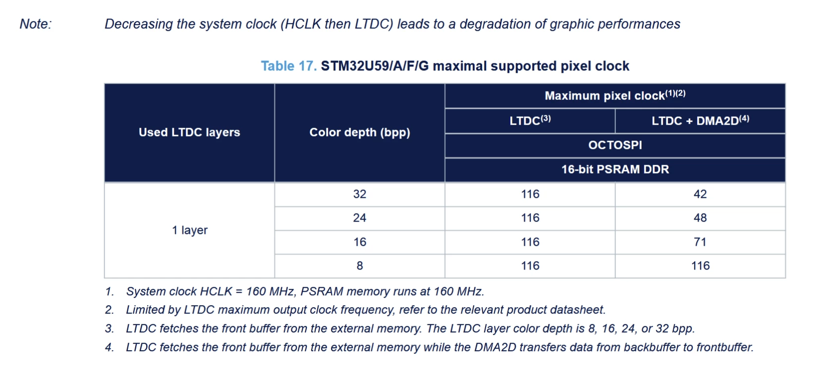

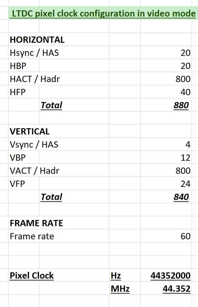

the refresh rate is 60Hz and the pixel clock calculated is 44MHz (values in the attached excel screenshot).
I did read that document a while back and from table 17 on page 31 (screenshot below) it seems to be ok and plenty of headroom (max allowed is 116MHz in the screenshot attached).

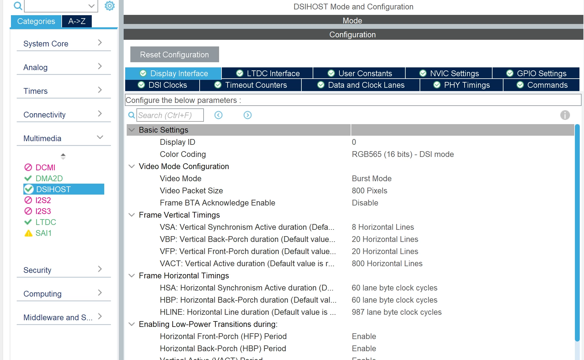

When I set the LTDC to 44MHz the CubeMX clock configurator auto-generates a DSI byte clock of 33MHz (264MHz DSI clock lane using 2 lanes). And that also seems well within the STM32U5G9 specs.
All that seems to suggest that I can drive the display specs I mentioned above.
Two questions please:
1. Are those calculations correct?
2. Also, whether I set colour to RGB888 or RGB565 (in LTDC and in DSI panels in CubeMX), the auto-calculated DSI byte clock is automatically calculated to 33MHz. Should it not change with the higher RGB (i.e. RGB888)?
Thank you :)

Your calculation is correct. and indeed Table 17 is the key one - you select your configuration at each Column and to ensure not exceeding the Maximum Pixel clock. for example, for Color Depth 24 bpp using LTDC and DMA2D up to 48MHz.  Regarding STM32CubeMX clock generation, you can force a manual configuration as well, let us know if you need further assistance.

my understanding is that in that scenario around 33MHz for the DSI byte clock is the minimum value. How much faster can I set the DSI byte clock while keeping the pixel clock at 44MHz? Can I push it to the DSI HOST's PHY maximum allowable or do I need to keep it around that 33MHz?
What is the logic/reasoning and pros/cons to decide the upper limit in this specific example?
Thank you :)
MM..1
Mar 19, 2025 6:35 PM UTC
LTDC clock is based on pixels ... 880x840x60 = 44,352MHz , but DSI clock is based on data to send and here seems you miss. For RGB888 video mode simple calc is 800x800x24x60 = 921,6Mbit/s for 2 lanes per lane around 460Mbit plus sync ahead . byte clock is 480Mbit/8 minimum.

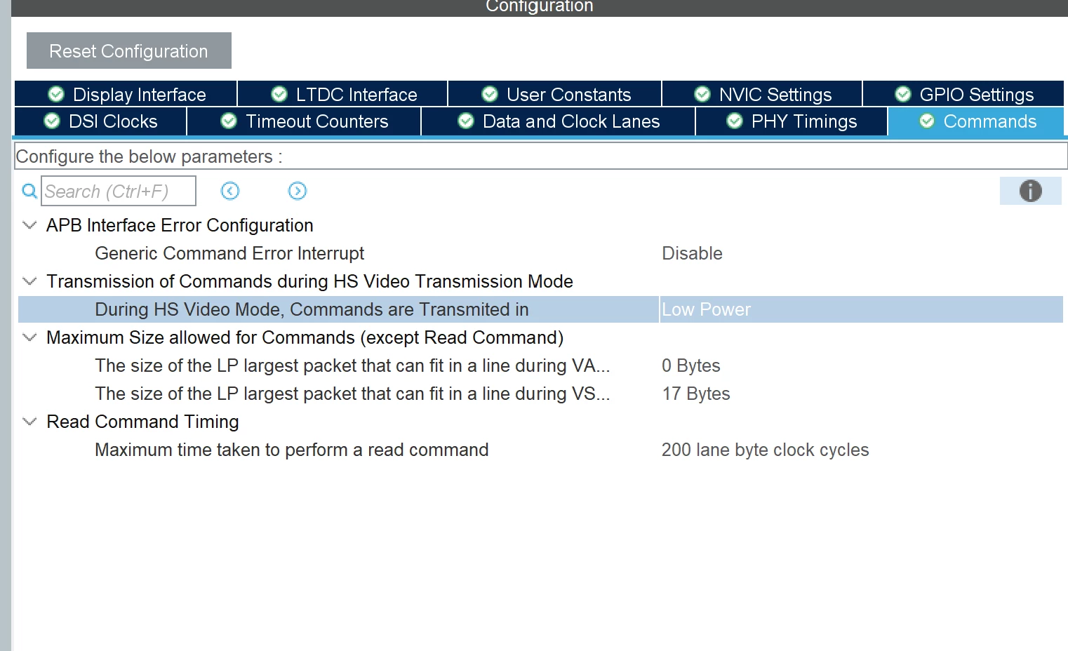

@Kelly3 To be clear, my set up is a bit different to yours as I'm using STM32F469, I have successfully interfaced to two different displays, one uses FL7705 controller and the other JD9365A controller, I have written bespoke drivers for both types of display controller. I'm also using 2 lanes MIPI DSI, I now have both display types working well but it took a lot of effort and time to get this far.
 Initially I tried to initialise in HS mode but the display was initialising correctly only about 50% of the time. I switched to LP mode and then found that I got bus errors, I can't remember what the error was but it sounds like this may be a similar issue to the one that you are having.
What I found was that when initialising in LP mode, the LTDC needs to be started before calling the display initialisation code, but when in HS mode, the LTDC needs to be started after calling the display initialisation code.
Below is my function MX_LTDC_Init from main.c and is generated by CubeMX, I have added code in USER CODE BEGIN LTDC_Init 2.
My display initialisation code is the function  TTH345BRS_Init()
When I switched to LP mode to initialise the display, I had to move the macro that starts the LTDC, __HAL_LTDC_ENABLE(&hltdc) to be before the call to the display initialistaion function TTH345BRS_Init().
On the other hand, in HS mode, the LTDC needs to be enabled after the display is initialised and is how CubeMX had originally configured the code. I dare say this works with some displays in both HS and LP mode.
I hope this helps.

@RobNewbury ,Thank you for your sharing!  I tried start DSI -> start LTDC-> initial display in LP mode, The display can't be initialized.  I guess F4 might be different from U5.
In your code, DCS long write, DCS short write, generic long write and generic short write are LP mode disabled, i.e. they are all set  to HS mode.  Is the above code for initial display in HS mode?
Are you using burst video mode? or other mode?
Dec 17, 2025 9:27 PM UTC
@Kelly3 I'm using HAL_DSI_ShortWrite() and HAL_DSI_LongWrite(), I'm using these in LP mode, I'm not aware that these functions are LP mode disabled, I am definetly using LP mode and they are working for me?
I'm using burst video mode, below is my DSI set up. Check that the VACT value is correct for your display. My other display is 720 pixels and I had the VACT set to 800 pixels, the display wouldn't initialise until I changed VACT to 720. I had thought that the VACT should include VS period in pixel clock cycles, however that is not the case.
Another mistake I had made was to initialise the display to RGB888 and the DSI to RGB565.
I hope that you get your display working.
