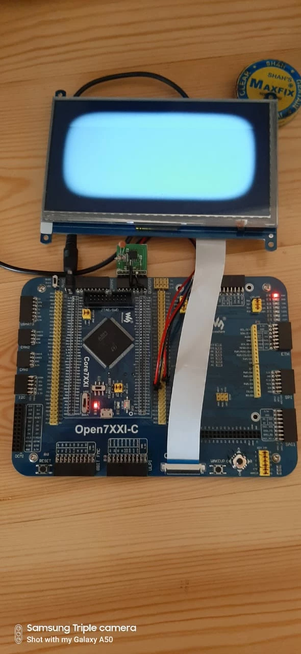

Hai....,
I am using Waveshare STM32F746IGTx Development board and Waveshare 7 inch(1024x600) Capacitive Touch display QUADSPI (MT25QL128ABA1ESE-0SIT Micron Technology) own development board STMCube IDE and Custom External loader file.
After upload the program i am facing following error
Erasing internal memory sectors [0 4]
Erasing memory corresponding to segment 1:
Erasing external memory sectors [0 1]
Download in Progress:
File download complete
Time elapsed during download operation: 00:00:17.751
Verifying ...
Error: Data mismatch found at address 0x90000000 (byte = 0x99 instead of 0x00)
Error: Download verification failed
Encountered Error when opening C:\ST\STM32CubeIDE_1.6.0\STM32CubeIDE\plugins\com.st.stm32cube.ide.mcu.externaltools.cubeprogrammer.win32_1.6.0.202101291314\tools\bin\STM32_Programmer_CLI.exe
Error in STM32CubeProgrammer
Debugger connection lost.
Shutting down...
where i am doing mistake, please give your suggestion.

0x99 suggests the QSPI device isn't responding. Could be wrong command address, pin config, etc.
M​ake sure your BSP code is fully tested and functional. Do this outside the loader.

Outside of CubeIDE you can use STM32 Cube Programmer directly, you should be able to select the External Loader (EL) and check you can read the QSPI content. Blank sections should be 0xFF, if you read 0x99 everywhere, again suggests an issue with the loader vs hardware

I am using following QUADSPI PIN CONFIGURATION:
PF9 -------> IO1
PF8 --------> IO0
PB2---------> CLK
PB6---------> CS
PF7 ---------> IO2
PF6 ---------> IO3
Now it show 0xFF in STM32 cube programer select Custom External loader N25Q128A_STM32F7-PB2-PF8-PF9-PF7-PF6-PB6-CLIVEONE, . But after upload the code (Using same External Loader ) showing error following bellow
Error: Data mismatch found at address 0x90000000 (byte = 0xDD instead of 0x00)
again go to check in stm32 cube programmer it show 0xDD select same External Loader.
without adding External Loader after uploading the program in Debug mode display showing white colour and four corners are Black colour it's looks like a Ellipses in shape.
I am change other two different PIN configuration of QUADSPI but it not work.
If i use inbuild N25Q128A_STM32F746G-DISCO External loader while uploading it will take to much time after showing following error.But it working fine in STM32 Cube Programer it show 0xFF.

It is using the Micron part and not the Winbond one?
Does your own BSP QSPI code work on this board/part combination? Have you tested Read, Write and Erase from your own application code?
When erased you should be able to see 0xFF pattern throughout memory space.
Confirmed WaveShare schematic as showing PB2,PB6, PF6,PF7,PF8 and PF9
746G-DISCO uses PB2,PB6, PD11,PD12,PE2,PD13
769I-DISCO uses PB2,PB6, PC9,PC10,PE2,PD13

Thanks for your support........, Yes i am using  PB2,PB6, PF6,PF7,PF8 and PF9 and Custom External Loader.
Yes... I have to tested Read, Write and Erase in STM32 Cube Programmer only working fine.
After the Erased it show 0xFFFFFFFF pattern throughout memory space,
Now code upload without any Error.
But after upload the code Display showing White Colour and four corners are Black colours, Connection are made as per Waveshare given schematic diagram.
Please find the attachment of Error Display Image for your reference.
Please help to rectify for this problem.
