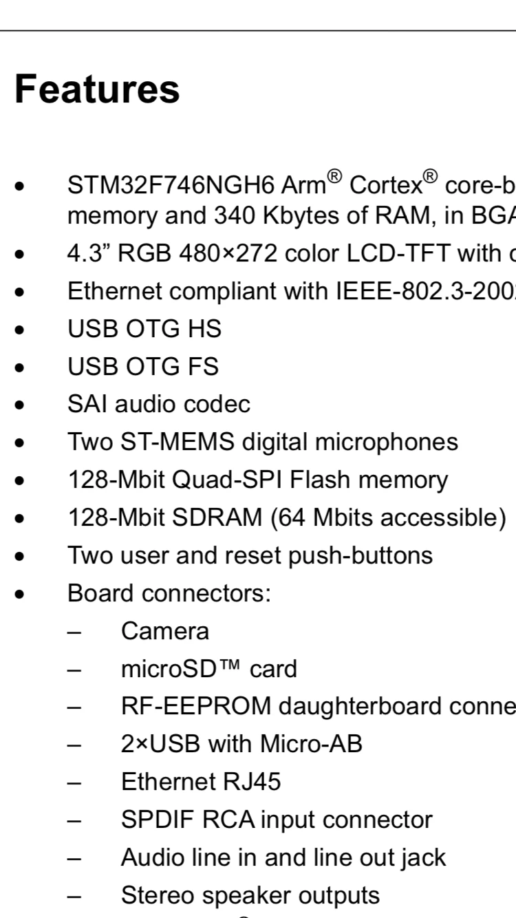

Hi everyone,
why they mentioned (64Mbit accessible only) in QSPI?
Tesla DeLorean
Tesla DeLoreanBest answer
Guru
Feb 3, 2020 5:40 PM UTC
It says it for the SDRAM, not the QSPI
Why, because they used a 32-bit wide SDRAM due to price, availability or physical size/package, but they only have 16-bit of the data bits wired up, due to pin availability on the STM32 side. Consequently half the available capacity is lost.

Oh lol I’m not good today, I thought for QSPI, sorry, then if it’s only the half is available! Supposed if I do, let say, a considerable application on this board, it won’t work? For example it might tell me SDRAM overflowed or something like that?
Tesla DeLorean
Guru
Feb 3, 2020 5:54 PM UTC
If you tell the linker you have 8MB (64Mbit) of SDRAM, it will tell you if/when you exceed the capacity.
If your application needs more SDRAM than that, you'd need to consider a different board to do the proof-of-concept on.
The SDRAM should be more than sufficient to sustain the screen buffer(s) for the 480x272 display.
I would generally avoid the SDRAM for code or stack as it is slower, and contended, the cache may hide most of this on the F7
