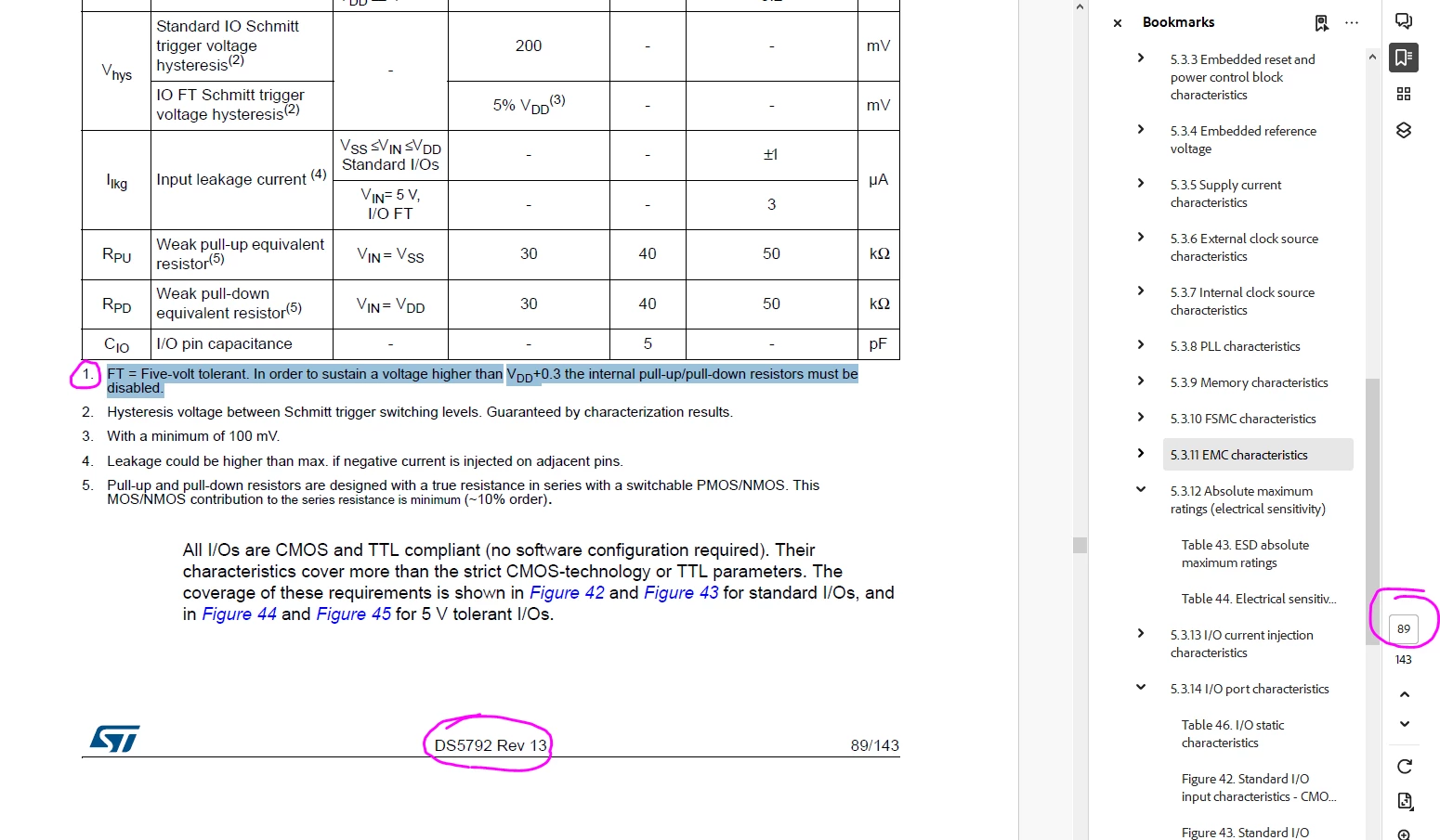

I am totally confused. According to DS5792 Rev 13, page 89, note 1:
FT = Five-volt tolerant. In order to sustain a voltage higher than VDD+0.3 the internal pull-up/pull-down resistors must be disabled.
This is opposite to what you said.
Visitor II
September 27, 2023
Sorry, you were right by "switch off", which means disable.

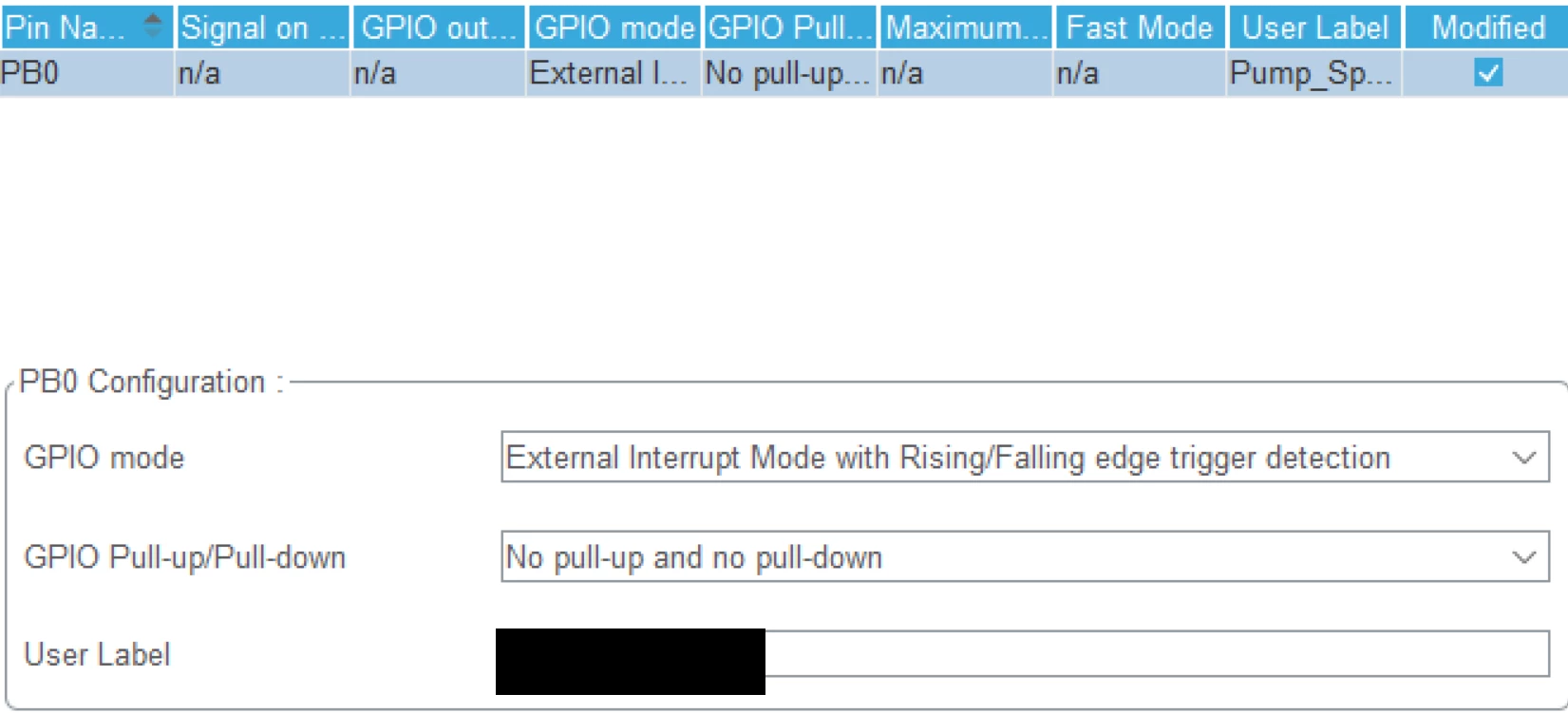

Yes, this answers my question. I am not using any internal pull up or pull down resistor on this pin. It is only being setup as a GPIO Input in external interrupt mode:
