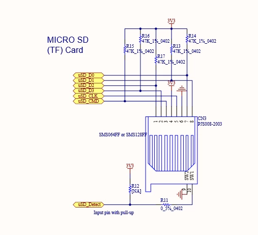

I have been breaking my head the past few weeks trying to connect an SD card to the STM32H723ZG with no success.
My setup is simple:
  1. Evaluation board is NUCLEO-H723ZG.
  2. SD card breakout board wired using 4 bit SDIO.
  3. 47K pull up resistors
  4. using CubeMX to generate the project. FW_H7 1.8.0
  5. connected the wires to CN8
  6. Removed SB14 SB 15 brideg resistors to the CN11
  7. Generate code with cubemx - configure it with SDMMC1, 4 bit SDIO
HW configure is seen in this image:
using 1 wire SDIO with this configuration everything works well.
using 4 wire SDIO we I get an CRC fail inside the HAL_SD_ReadBlocks function .

Tesla DeLorean
Guru
Dec 15, 2020 8:03 PM UTC
Sorry not a CubeMX adherent.
I have SDMMC/FATFS working on several of the H7 NUCLEO boards, not sure I've ported it to the H723 board, but I do have one.
Electrically the 4-bit mode is a lot less forgiving, but if the socket/wiring has been tested/proven elsewhere it should work here.
Double check the TRANSCEIVER is not used/enabled in the H7 driver code.

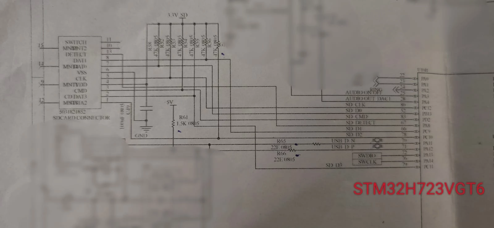

N$8130
Visitor II
Dec 26, 2022 12:52 PM UTC
@heveskar​  , @Community member​ , @DYeru.1​ ​
Hello everyone,
may you please confirm, how you shorted out this problem.
i have also facing same issue with my project,
my task to run sd card(ver 2.0) with STM32H723VGT6 Micro(100 Pins) to audio record and play back purpose!
kindly please confirm/share related connection diagram/exact schematic /related reference.
Thanking you

N$8130
Visitor II
Jan 4, 2023 5:40 AM UTC
AF12...?
all above pins have externally pull up ,is it correct connection?0693W00000Y7MBGQA3.jpg
