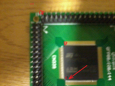

    Yes, so you've got the orientation wrong
    nawfal3
    Visitor II
    April 21, 2014
    Posted on April 21, 2014 at 21:58
    Thank you..It worked .... I was confused by the logo orientation on STM32CubeMx...I didn't see the circle markation... Thank you again
    nawfal3
    Visitor II
    April 22, 2014
    Posted on April 22, 2014 at 13:45
    I have made many successfull tests programming the chip either from em::blocks or from STM32 ST-LINK Utility (V2.J19.SO)... The problem that I have is that when I connect to the chip via STM32 ST-LINK Utility the application recognize the chip by giving the ID but it is no more able to erase it or program it....Same thing with em::blocks. (I am using SWD) Under Windows7
