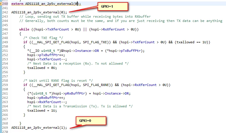

I am using a chopped-down function from the Cube HAL code to talk to a serial FLASH. The original function has a mass of options which were checked at runtime - the usual thing for HAL code...
It's all working fine. SPI2, 21MHz (the fastest I can go with PCLK1=PCLK2=42MHz).
But testing the speed, I am seeing 600us time taken to read 512 bytes. The SPI speed limit should be about 200us. The actual time, obtained by waggling a pin, is 600us. Can anyone see anything obviously wrong with this code? As I say, it works perfectly.

25 replies
waclawek.jan
Jan 12, 2022 1:03 PM UTC
You can easily exclude problems with ocassional lengthy delays caused by interrupts simply by writing a simple test program which does NOTHING but dump 512 bytes through SPI. It does not need to be meaningful for the sFLASH itself, you just observe the bus/timing.

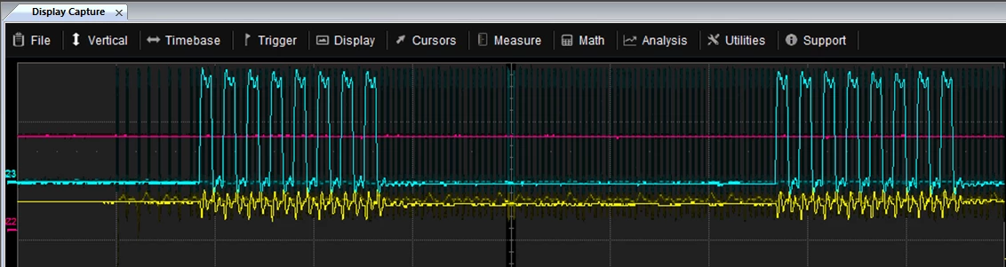

Jan 12, 2022 4:27 PM UTC
OK here we go. Spot on, the clock bursts have gaps of exactly 2/3 of the time.
The zoomed X axis is 200ns/div.
The waveform is ringing because I am probing the board without decent scope grounds.
Ignore other traces - they are irrelevant. Just the clock.
So what the hell is it waiting for during those 800ns? 2 whole byte periods.
To recap, this is the code
The title of the thread should say 1/3 not 1/2.
Jan 12, 2022 4:33 PM UTC
As we've been saying all along, the code cannot keep up with the data rate. Use DMA, higher optimization settings, or your own code to overcome the issue.
800ns is not a ton of time in terms of cycles. Did you specify your CPU clock rate anywhere in this post?

Jan 12, 2022 4:48 PM UTC
168MHz.
No, there is something in that code which is waiting exactly two byte periods.
Some timing issue, but I can't see it.
Maybe one of the two USART flags is not indicating the status until something else happens.
An example of this, not relevant here, is that you cannot (with most UARTs) get a "TX buffer empty" interrupt unless the TX buffer becomes empty, so you have to load a byte in there first (often that is done by a timer ISR).
waclawek.jan
Jan 12, 2022 4:53 PM UTC
Or executing code takes exactly two byte.
Have you read out and checked the SPI registers content? Do you have interrupts enabled on that SPI?
