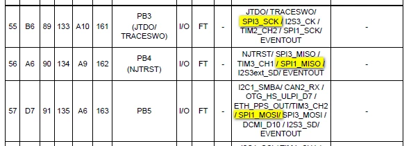

32F417: Mapping SPI1 to the SWD debug pins PB3-PB5 - how can this work?
One of the AF options on SPI1 is to use the SWD debug pins PB3-PB5.
How can this be used in reality?
Pretty obviously you can't do SWD breakpoints when SPI1 is thus mapped!
But assuming no SWD debugging is needed, and you use SWD just to program the FLASH, how does one implement this? AFAICT one would need
- on SWD inputs, FLASH loading will work
- on SWD outputs (e.g. SWO - the SWV ITM debug output), FLASH loading works because these pins power up in some mode suitable for SWD FLASH programming.
Then when the code starts running, you will need some logic to disconnect the debugger, so the clock and data SPI signals can come out, without contention with the debugger.
Maybe I am missing something obvious. Or maybe this SPI1 AF mapping option is intended for FLASH programming not via SWD but via a UART, CAN or the weird USB mode.
PB3 may not need anything because the SPI CLK is an output and the SWD SWO signal is also an output

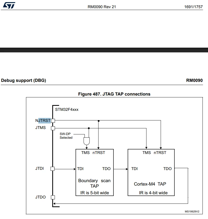

And even after your code has configured the pins, NRST=0 should cancel that out.
I also note that PB4 is SPI MISO which is an input, just like NJTRST is an input. So maybe this AF was carefully chosen after all :)
In SPI usage, PB4 will be driven (by the SPI Slave's MOSI) so one needs to arrange for that signal to go tri-state when NJTRST=0. But what does NJTRST actually do? It came up here
https://www.eevblog.com/forum/microcontrollers/st-32f4xx-debugging-and-njtrst-mystery-does-it-do-anything/msg3564987/#msg3564987
and it seems you can ignore it. I have a 10k pullup on it but otherwise do not use it. However I never set it to 0, which is exactly what will happen if you use it for SPI.
The thread says it just resets the debug controller.
It's only relevant if you're using actual JTAG - not SWD.

OK so one needs to be sure that putting muck on NJTRST does not break anything.
EDIT: just seen your PS. Can we be sure waggling NJTRST will not break anything, either during FLASH programming or during code execution?
Stuff appearing on NJTRST could well violate reset timing specs on the TAP controller.

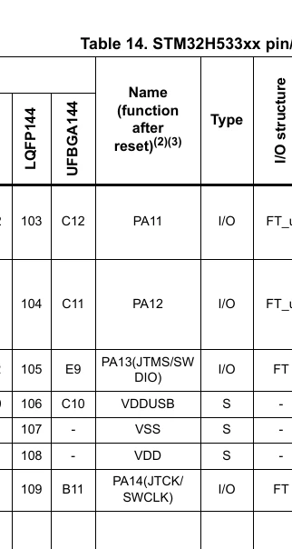

AScha.3
Dec 14, 2025 8:04 AM UTC
You see in ds what pins are after reset: here from H533
Depending on boot0 pin/signal after reset core starts bootloader or user program.
And after power up the debug unit waits for a "key" sequence, to start swd or jtag actions - or stays sleeping/waiting . So you can still connect "under hardware reset" to the debug unit , even if user program would use the swd pins for other functions and so debug impossible , as soon as user program has control and gpio init is done.
waclawek.jan
Dec 14, 2025 9:28 AM UTC
What if the chip is powered up without a debugger. Is SWD the power-up default i.e. the JTAG portion does nothing at all unless some "code" is sent on the debug pins to configure it?
The power-on default is JTAG, and it does nothing unless - as you say - some "code" is sent to it. This involves wiggling TMS and TCK, as long as these pins are static (rigorously speaking, if TMS is high), nothing happens externally. TMS is pulled up after reset (see GPIO chapter in RM), so if that pin is unconnected, everything is safe. TMS and TCK are also - and not coincidentally - the SWD pins, and to switch on SWD (and disable JTAG), another "magic code" has to be "played" at those two pins; that "magic code" is deliberately designed so that no part of it can generate a valid JTAG instruction, so you can hot-plug the SWD connector while the debugger is playing continuously the "magic code" and it won't switch to JTAG.
TLDR is, that as long as you use the SWD pins only for debugging, you are safe. So yes, some thought went into these things, which are btw. designed by ARM, not by ST.
Just a side note, nTRST is an optional JTAG signal which does nothing with the DUT (i.e. the mcu itself), it just resets the internal JTAG state machine.

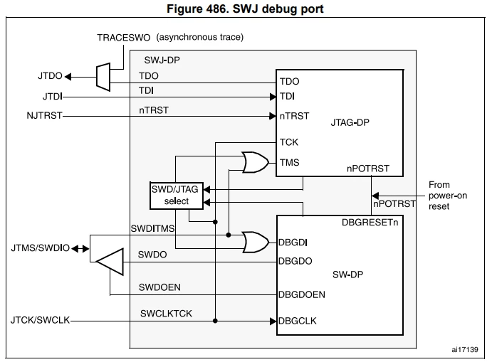

waclawek.jan
Dec 16, 2025 11:24 AM UTC
> So the SPI1* (remapped to PB3-PB5) will obviously not work.
It's not obvious. Why would that be?
As I've explained above, PB4 set to NJTRST has nothing to do with SWD, it's a JTAG signal and JTAG is inactive once the debug interface is in SWD mode.
PB5 has nothing in common with debug at all.
PB3 in SWD mode *can* be set as TRACESWO, so simply don't set it as such - not in program nor in IDE - and you're fine.
As a second thing which makes sure SPI works is, that if PB3 and PB4 are set as AF in GPIO_MODER and to 5 (which is for SPI1) in GPIO_AFR[], the debug functions are disconnected and SPI is connected to these pins.
PHolt.1
PHolt.1AuthorBest answer
Senior
Dec 16, 2025 12:22 PM UTC
"It's not obvious. Why would that be?"
I am happy with the target doing the right thing, but was worried about the debugger's output pin(s) remaining active, whenever it is connected to the target.
But you are right. The two signals the debugger will be driving will be JT-SWDIO and JT-SWCLK. It then monitors JT-SWO. These are PA13 PA14 PB3 respectively.
So we are left with the possible PB3 conflict. AFAICT the SWO mode is selected by the debugger after the target /reset is removed (one of the "hidden" things the debugger does to the CPU) so the question is whether setting up the AF for the SPI mode will disable SWO (specifically, disconnect PB3 from the SWO circuit and connect it to SPI). The info I can find states that selecting AF5 disables SWO, and experimentally I can confirm this.
This should do it

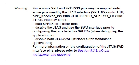

Dec 21, 2025 6:07 PM UTC
Turns out that page 873 of the 32F417 RM has this note
My interpretation of it is that this is fine provided your code does not re-initialise these pins until the debugger has finished with them.
When they say "disable both JTAG/SWD interfaces" they surely mean when the debugger has finished, because user code has no means of controlling JTAG/SWD.
