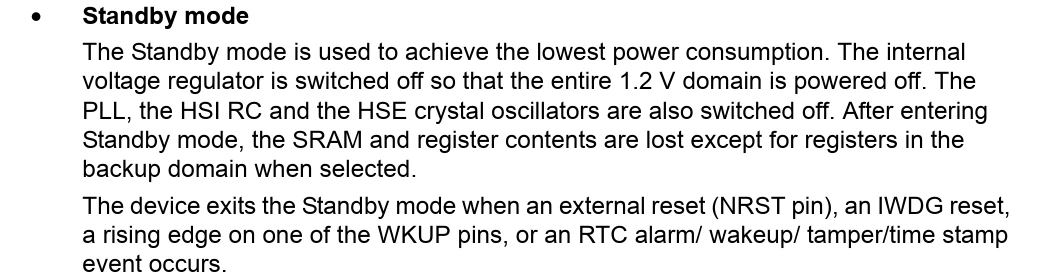

Depends on the sleep mode , if its Standby ...then, from ds:

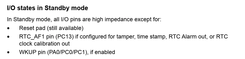

and from rm:
So some pins still working (to wake up cpu) , but all other ... hi Z , off.
So better put a pulldown/-up on every output pin, that would float otherwise.
