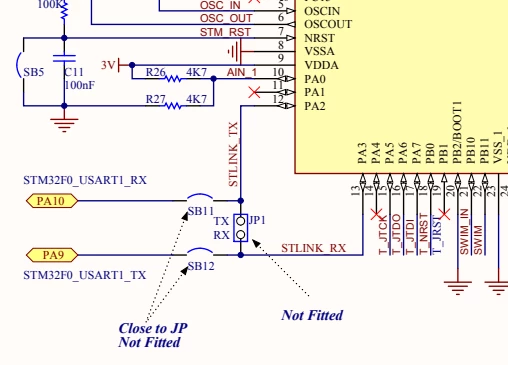

On F072 board, then check connection:
SB11 + 12 , to connect to usart1 of F072 ; then send on usart1 -> st-link/VCP -> PC (terminal or console in IDE).

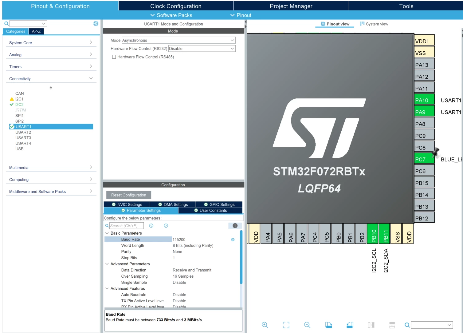

I tried closing those jumpers and enabling the USART1 Interface:

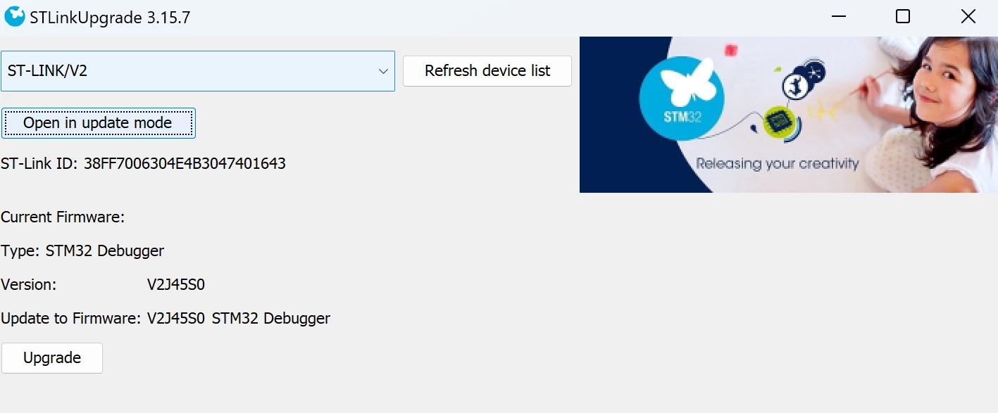

However, i still do not see the COM port come up. When you mention updae the st-link, is there an external tool I can use to do that. I tried to "upgrade" but it does not let me select a version called 2.1, see below:

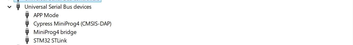

I haven't tried to print anything yet, but I do not see a COM port come up when I plug in the discovery kit. I only see the st-link

Ok, (i put the j-link debug on my F072-disco ), so i cannot try now.
But if you stay on V2.0 , no option to V2.1 - then no VCP option there.
(And i could ask STM, why connect uart1 to st-link, if no option to use it -- =
Did you try : open in update mode ? If cannot set V2.1 , with VCP , no serial there.
Try..

btw
on other board, like STM32F3DISCOVERY
you see:
