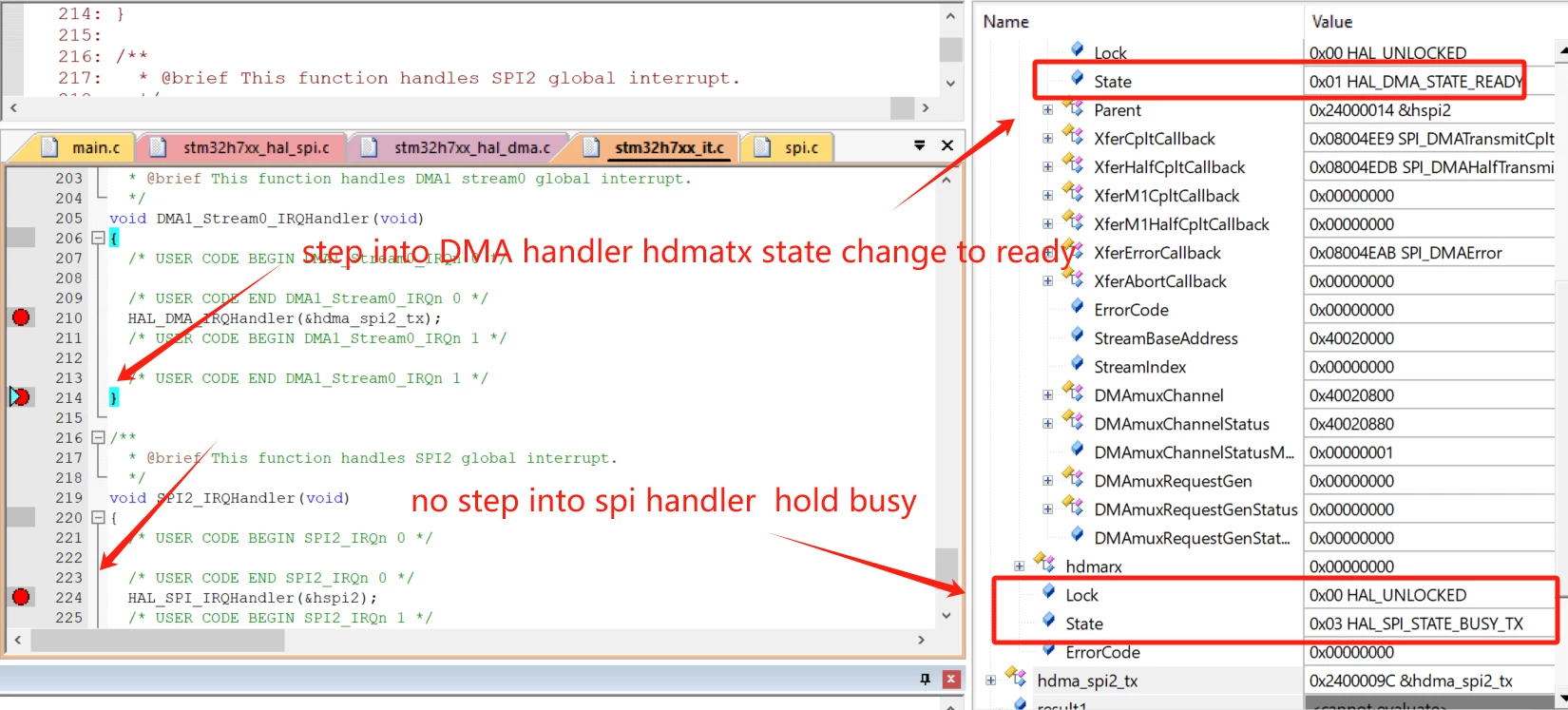

32bit SPI DMA, not triger SPI interrupt hold busy state
Controller: STM32H750XBH6
Development Environment: CubeMX + MDK V5.27
Issue Background: The DAC chip requires the use of 32-bit SPI. Currently, it works normally with a polling method. There is a need to use hardware SPI + DMA to increase the speed.
  • When only the following three items are changed to 8-bit mode, the single-byte DMA transmission can be sent multiple times, and the function is normal.
hspi2.Init.DataSize = SPI_DATASIZE_32BIT;---------------->8BIT
hdma_spi2_tx.Init.PeriphDataAlignment = DMA_PDATAALIGN_WORD;------->BYTE
hdma_spi2_tx.Init.MemDataAlignment = DMA_MDATAALIGN_WORD;------>BYTE

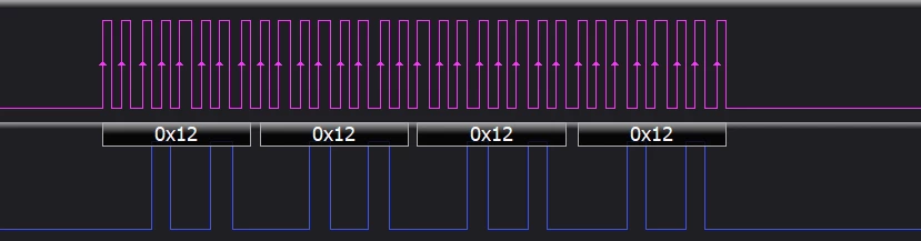

  • In the current code, when using the HAL_SPI_Transmit_DMA() function for the first transmission, the waveform can be seen on the logic analyzer (it can enter the DMA interrupt), but it does not enter the SPI interrupt, causing SPI_Busy.
  • The current code, due to being in a Bus state, causes all subsequent DMA transmissions to return directly.

1 reply
Lead II
March 4, 2025
maybe a misunderstanding of Polling vs. INT-mode, vs. DMA-mode?
If you use SPI in DMA mode: you should only use DMA related interrupts, such as DMA done.
INT-mode related interrupts are not needed - and I think, not enabled, not used anymore.
If you configure SPI in DMA mode -potentially the INT-mode related interrupts are not enabled, not configured (and not needed).
Just in INT-mode, you get interrupts related to SPI busy, empty etc. In DMA-mode - and if you get DMA INTs - these are the only hooks to synchronize. You cannot mix INT and DMA-mode (and their interrupts).
