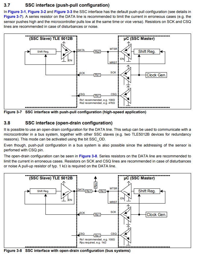

3-wire SPI (SSC) configuration
- 7 replies
- 6319 views
Hi
