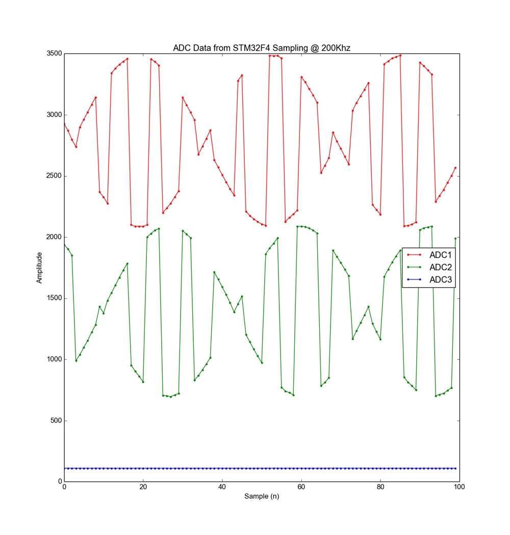

We are currently working on using the three ADCs on the STM32F407 to simultaneously sample three analog waveforms. Our target waveform is at about ~30Khz, but to illustrate our problem I have slowed the input waveforms down to 3Khz.
We have been capturing data by running our code through the debugger and exporting via gdb (using ST-UTIL in linux). This is our output. The waveform generator we are using to get these waveforms is also being measured with an oscilloscope; the sign inversion is not seen there. This leads us to believe it is being introduced somehow by the STM32F4. What is particularly curious is that the DC component of the individual signals is correct (i.e. ADC1 is offset above ADC2 and ADC3 is not connected to anything). Any suggestions would be greatly appreciated.
