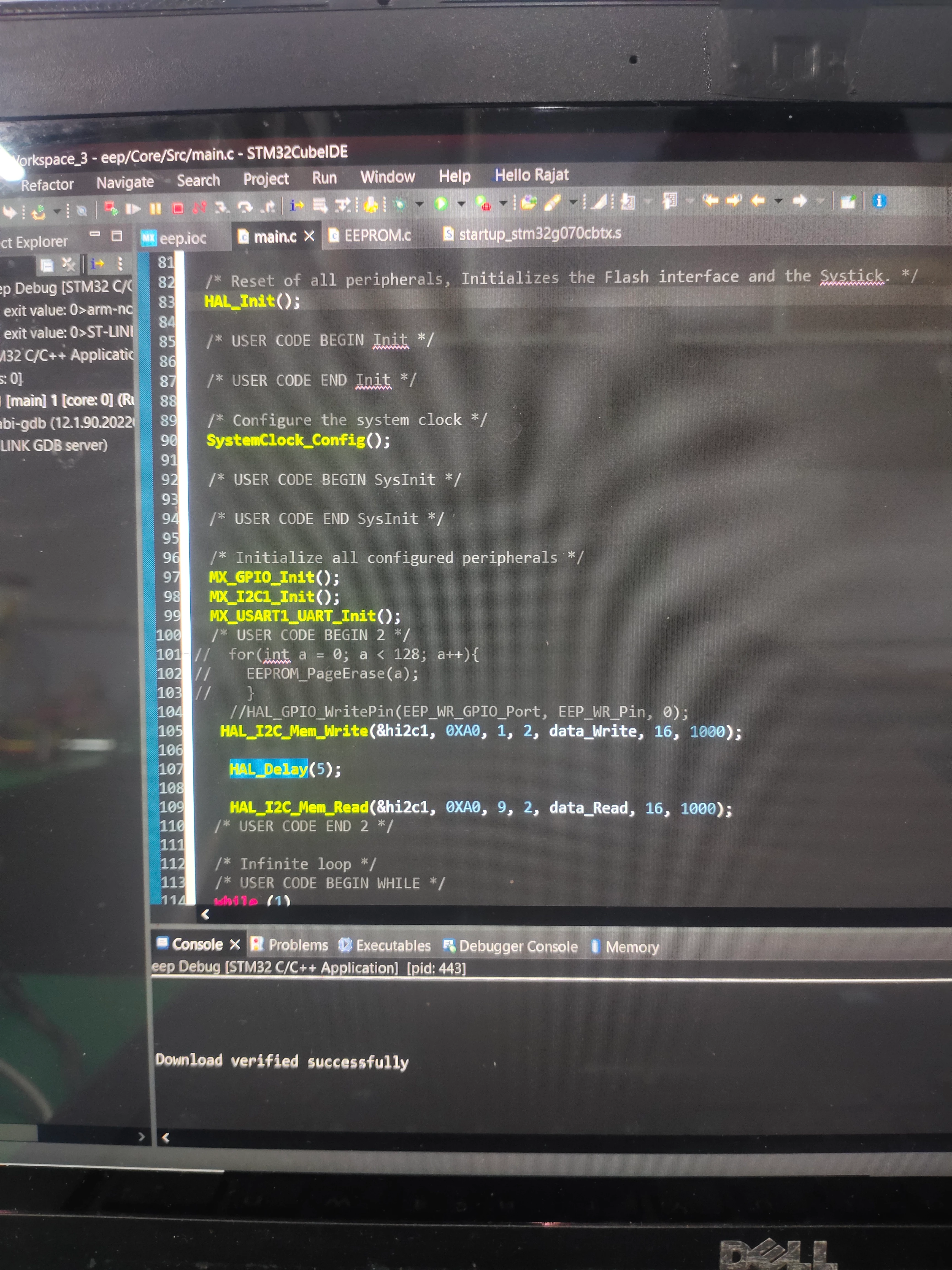

Hello all,

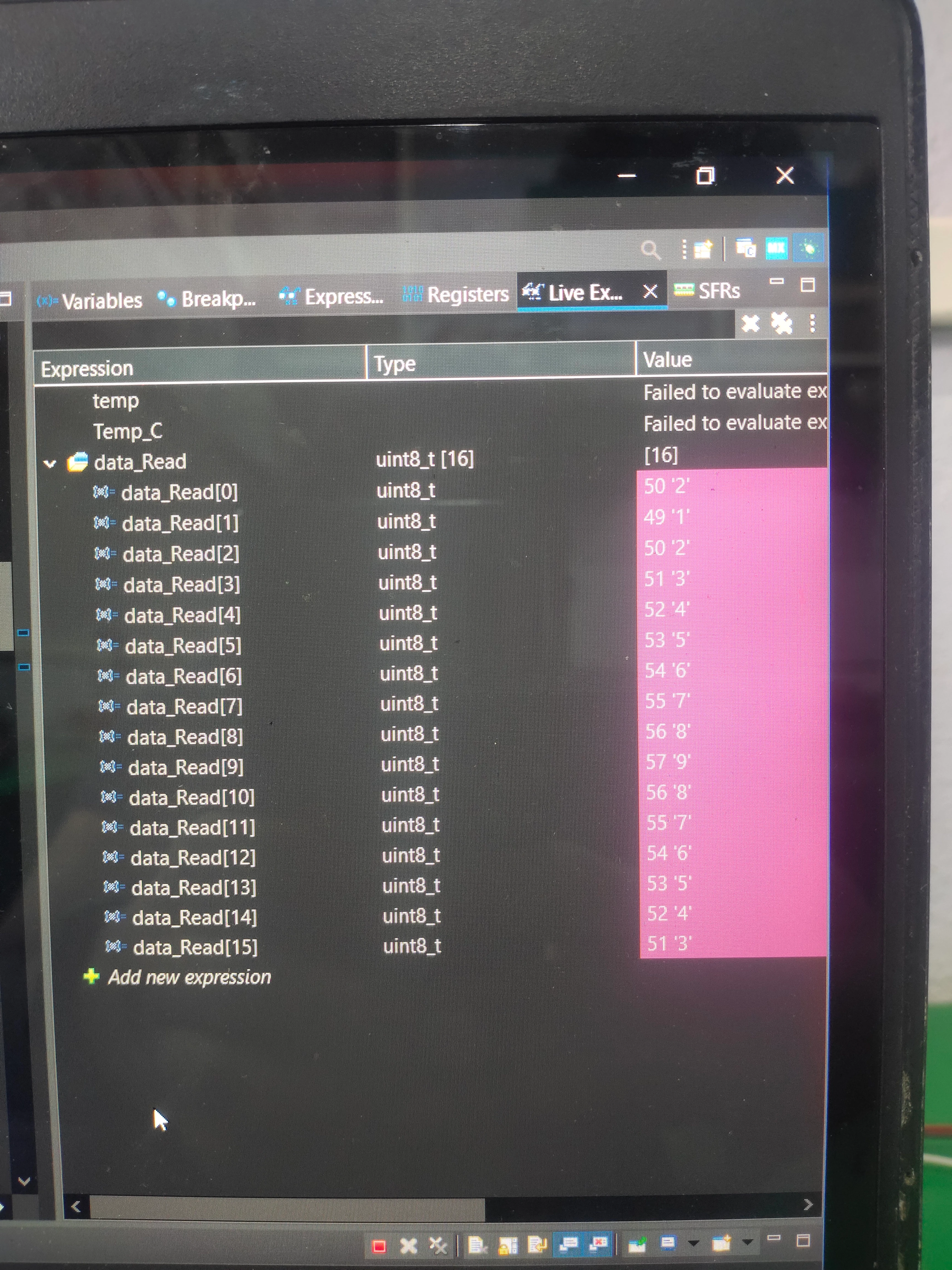

I am trying to interface 24C16RP EEPROM with my MCU soldered on breakout board and  it seems like the EEPROM is behaving very weird when i am trying to write and read. first of all it starts to write from position 1 not from zero of an array that i have created to store the data and i tried a lot to figure out the cause but i couldn't and the weird part is that after writing to a specific page if am trying to read any other page of the entire page address it returns the same date i have written to it. As i know this EEPROM has 16 byte of page size and 128 pages correct me if i am wrong. With that said i am attaching the cube mx code and the ioc file and some screen short for your better understanding. Please help me if you find something error in my code.
Thanks
uint8_t data_Read[16];
uint8_t data_Write[16]="1234567898765432";
int main(void)
 HAL_Init();
 SystemClock_Config();
 MX_GPIO_Init();
 MX_I2C1_Init();
 MX_USART1_UART_Init();
 HAL_I2C_Mem_Write(&hi2c1, 0XA0, 1, 2, data_Write, 16, 1000);
 HAL_Delay(5);
 HAL_I2C_Mem_Read(&hi2c1, 0XA0, 9, 2, data_Read, 16, 1000);
 while (1)
 HAL_UART_Transmit(&huart1, data_Read, 16, 1000);
 HAL_Delay(1000);
As you've mentioned above the page size of this EEPROM is 16 bytes.
What do you think will do the above code line? (write 16 bytes, from index 1) ? Is this intentional (you want to test how the wrap-around works?)

i want to know why it starts writing from index 1 and the data which should be written on 15th place is getting written on 0th place and if i am trying to read the data of any other page it returns me the same data.

This Eeprom has only 1 Byte of Address, to access the full 2K array you have to put the 3 high Bit's in DevAddress ( 0xA0, will give You the first 256 Byte, 0xA2 the next 256 Byte etc.)
Please read the datasheet.

I don't understand what you try to do, but reading the datsheet of the 24C16RP, You will see that this device has only a 1 Byte Address length, so the 4. parameter has to be 1. With 2 the device will write the low part of Your address to the EEPROM!
