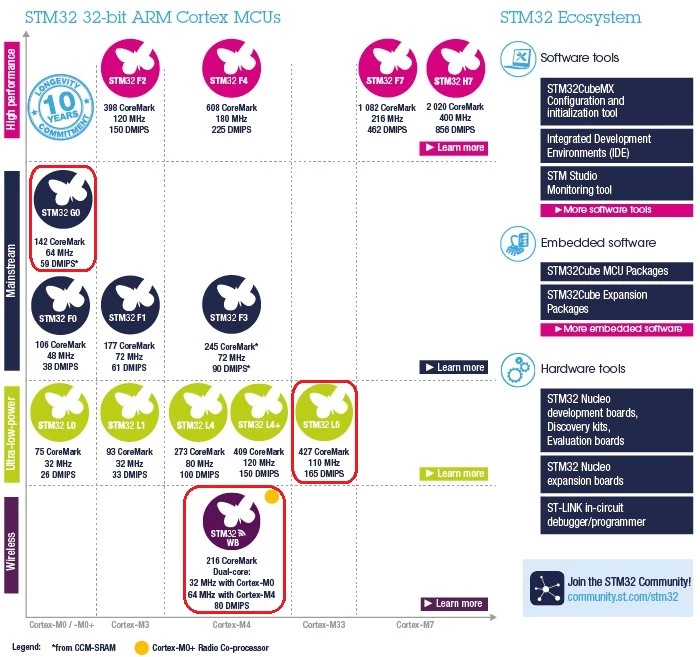

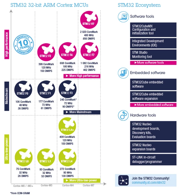

If we come back to the STM32 portfolio end of last year, it was like this:
Now the image is getting larger with new products as well as ecosystem components:
Compared to the wishes you shared previous years, we weren’t able to answer all proposals for sure, but may be some of our solutions met what you looked for. Like for example: delivering .ioc file in the STM32Cube package which we started with STM32G0...
