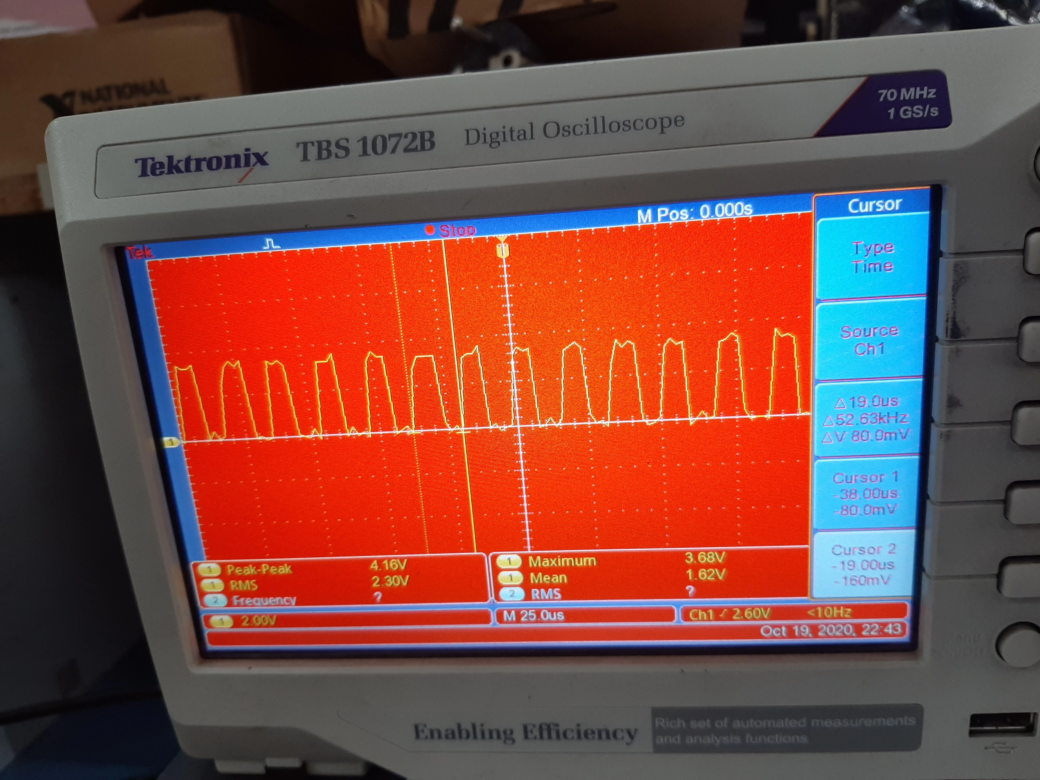

Hi!,
I am trying to generate pulse with PWM output with 2 micro second period and 50% duty cycle on STM32F373RCT6 on custom board. I have used Timer5.
APB1 frequency is 70MHz.
Prescalar value is 69 to generate counter clock frequency of 1MHz.
ARR value is 2 to give period value of 2 micro second.
Pulse width is 1 to generate 50% duty cycle.
But PWM Output frequency is coming 1.11khz (900 micro second).
Please help me in this matter. If any other information required please let me know.
Regards,
Gaurav

Set Prescaler = 0, Period = 140-1, Pulse 70
GAGGA.1
GAGGA.1Author
October 20, 2020
I tried with these values but still I couldn't get desired values. Please find attached PWM Output waveform snap.
I configured Timer5 (PC0) for PWM output as per configuration given below.

>>If any mistake I did please let me know
52.63 KHz x 140 is approximately 8 MHz, not 70 MHz
Poor frequency suggests running from HSI not PLL

> Client requirement is to use external oscillator.
That's OK. Just make it as an experiment so that you are confident with the timer settings.
Also make sure you are not fooled by aliasing on the oscilloscope. Switch to higher horizontal, resolution, 1us/div or so.
