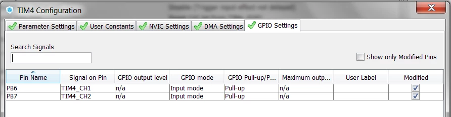

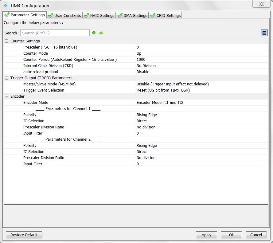

I want to run 2 rotarty encoders on my STM32F I'm using cubemx.
The first one is a 2000 step rotarty encoder like these:
https://www.aliexpress.com/item/1pcs-E6B2-CWZ1X-2000P-R-encoder-for-Omron-2000-line-rotary-encoder-2M-incremental-encoder/322275014html
I use TIM4:
And everything works perfectly

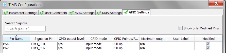

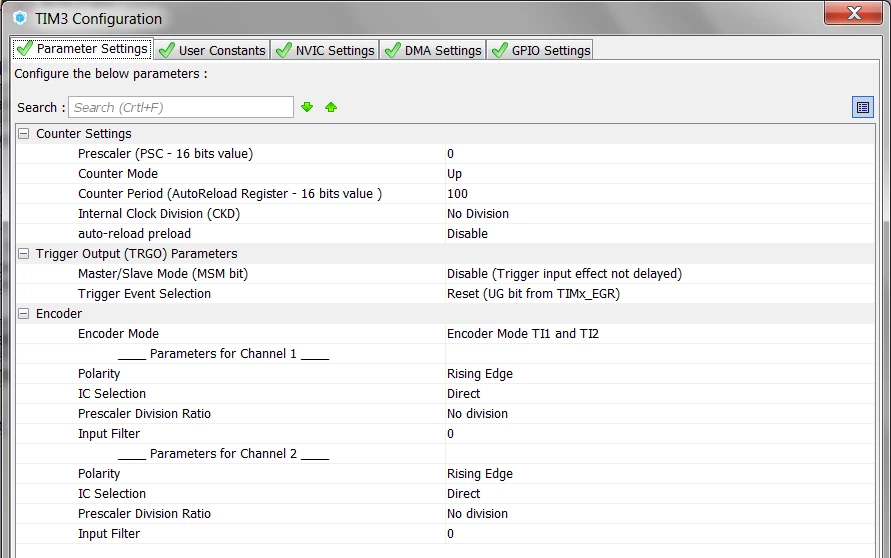

But on TIM3 I use a different encoder type:
http://www.mpja.com/Rotary-Encoder-with-Pushbutton-Switch/productinfo/30403+SW/
It has only 3 pins
I wired up like this:
except i didn't used PB6 and PB5
and here is my setup:
Any idea why it's not working?
Thank you very much for your help

    In debugger, observe the relevant bits of IDR register of GPIOA. Depending on debugger, you may need to refresh manually or switch on autorefresh. Turn slowly the encoder, holding it in various positions between the detents. Do you see both pins changing from 0 to 1? (if not, check connections). Do they change in a different moment (if they change simultaneously, there's a short between them).
    If both these change as expected, check if MODER and AFR are set properly in GPIO, and then check the timer registers.

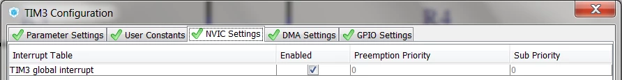

    Hi Jan,
    IDR6 and IDR7 of GPIOA are moving but not on each step. This is a mechanical encoder so i can feel each position
    when i turn slowly from one position to the other, sometime IDR are changing sometimes not. but the value of my variable is still the same
    I tried to wire my optical encoder instead of mechanical encoder and it's not working either
    Edit:
    stupid thing, i just forgot to start tim3 interrupt:
    HAL_TIM_Base_Start_IT(&htim3);
     sorry for time waste !

    Posted on May 18, 2018 at 17:50
    In encoder mode, the result is in the timer's counter (TIMx_CNT). Don't use interrupts.
