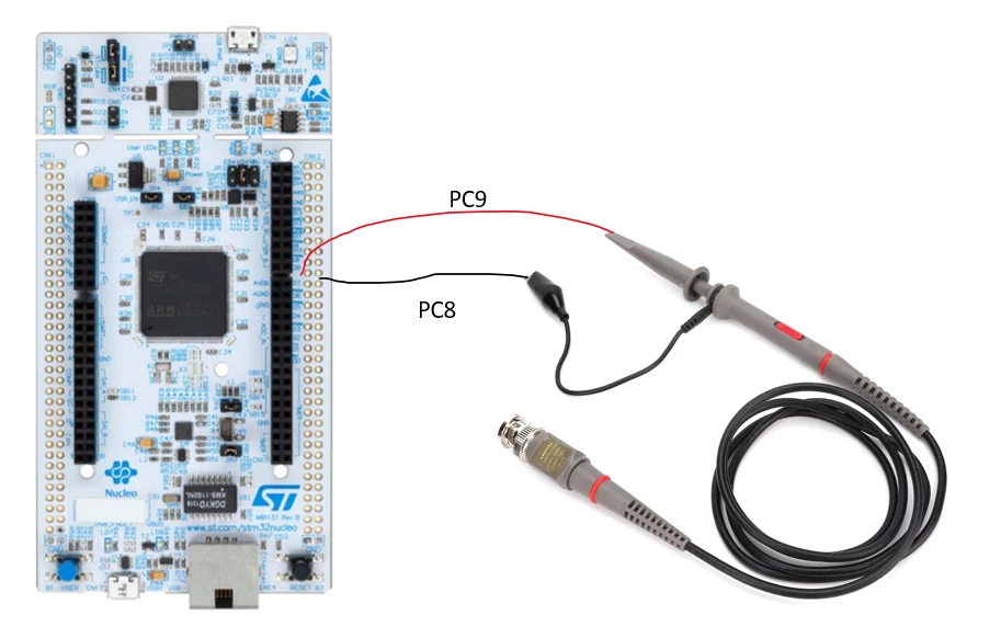

    > But when measured PC8 - PC9 with osiloscope nothing show in my osiloscope.
    Are you connecting GND on the scope to PC9? That won't work well. What does "nothing" mean here? Scopes measure voltages, "nothing" is not a voltage measurement. Is the voltage 0? How exactly are things connected?

    Hello TDK, thank you for your answer. Connection is like this;

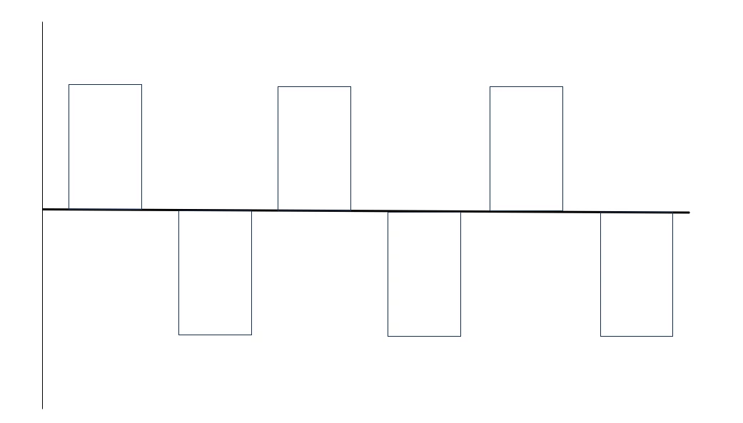

    And my desired outoput graph is this;
    Nothing means straight line. Probably there is no phase shift between outputs. And the results no voltage differenceses between outout so nothing shows.
