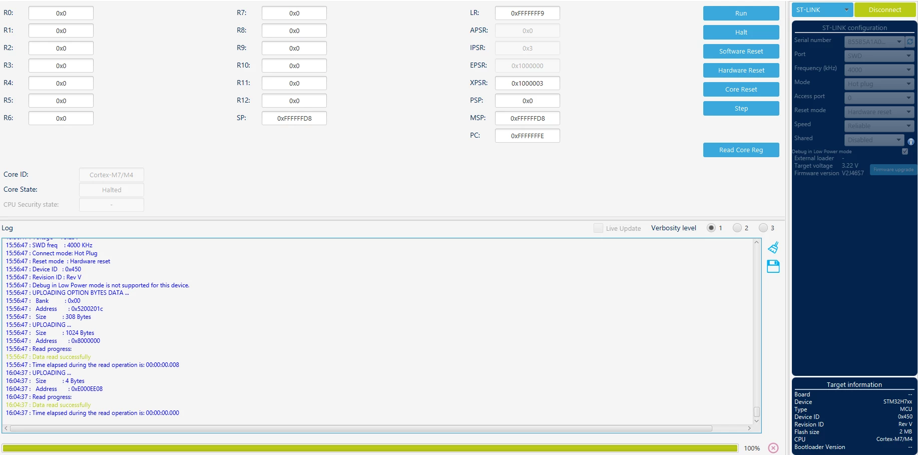

Btw, here is a picture from stm32cubeprogramer whith info of the mcu

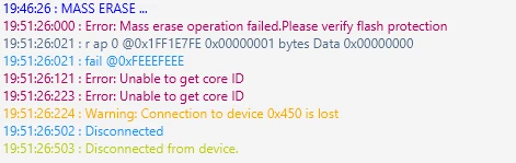

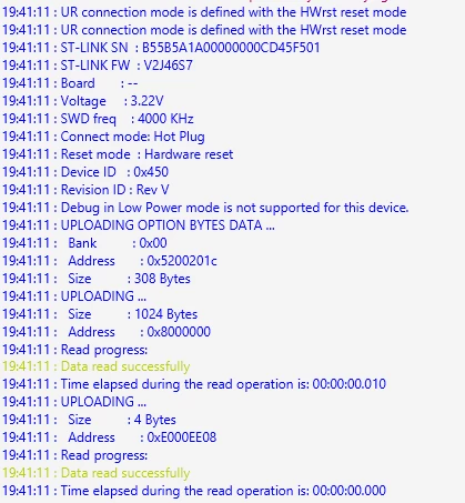

These are the logs that show up when I connect the board
and these are the logs when I try to erase the flash
I'm sending this because this was the source of my problem but I'm not sure if this has something to do with what I have comented about the 2.2V on VCAP.
Could this be asociated with a hardware problem or software?
