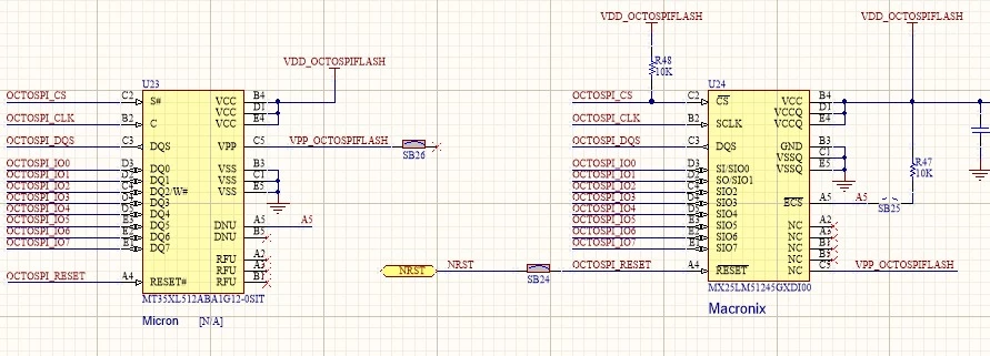

The STM32L4R9AI documentation says that it supports Macronix MX25LM51245GXDI00 and Micron MT35XL512ABA1G12-0SIT Octo-SPI Flash memories. These modules are not currently available for sale.
Please tell me, is it possible to use MX66LM1G45GXDI00 instead?
What other Octo-SPI Flash memory can I use for the STM32L4R9AI?

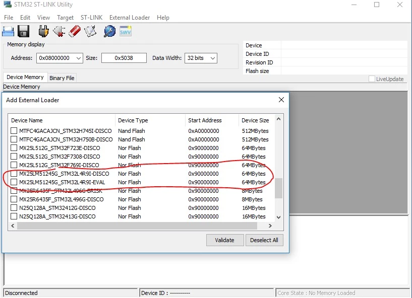

Not sure there's anyone here to do that kind of due-diligence. Odds are you might still need to code for changes and write external loaders etc?

Thank you for your help. These modules are not currently in stock. The MX66LM1G45GXDI00 is very similar in its characteristics to the MX25LM51245GXDI00, so I decided to consider it as an alternative. I need this memory to work with AMOLED via MIPI.
I would be grateful if you write in more detail how eMMC can be used instead of MX25LM51245GXDI00.

After checking the memory datasheet, MX66LM1G45GXDI00 should be supported by the STM32L4R9AI.
For more information please check the "Supported devices" section of the Octo-SPI Interface Application Note (AN5050).
