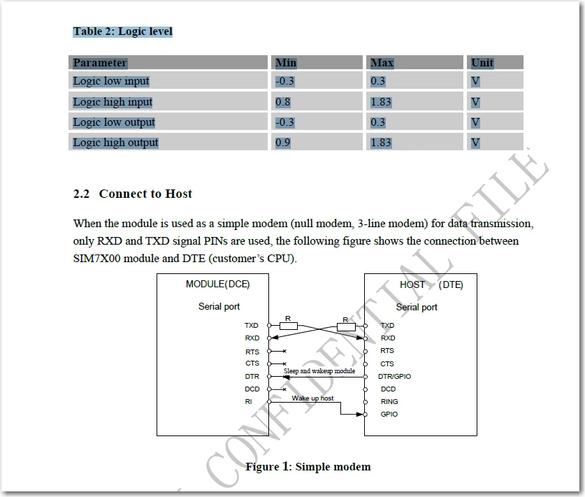

is it possible there's an issue with voltage level and grounding ?
I used a power from Desktop USB with a different port and from the documentation, it needs 1.83V max...
