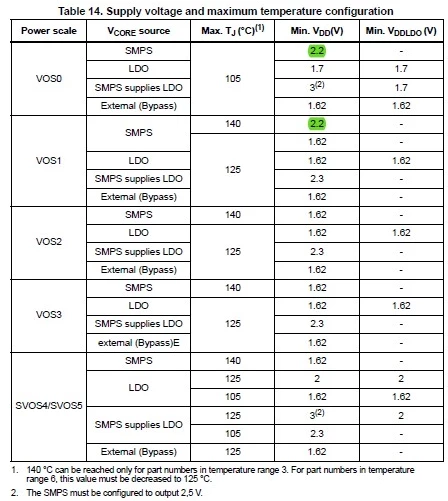

I'm designing a board based on the STM32H735IGK3 microcontroller in which I want to include two HyperBus / OctoSPI memories in multiplexed mode. For this kind of memories there is more avaiblity on 1.8V power supply, but reading the documentation of the microcontroller, I'm not sure if I can power it without lose performance.
I plan to use the included SMPS to optimice the power consumption, but I understand that if I use VDD=1.8V I can't  use the VOS1 and VOS0 modes, right?

The minimum VDD that can be used with VOS0 and VOS1 SMPS  is 2.2V.
So if your application requires VDD=1.8 V and the SMPS, you need to use VOS2 or VOS3 or SVOS4 or SVOS5.

Thank you very much @KDJEM.1, that's just what I understood.
