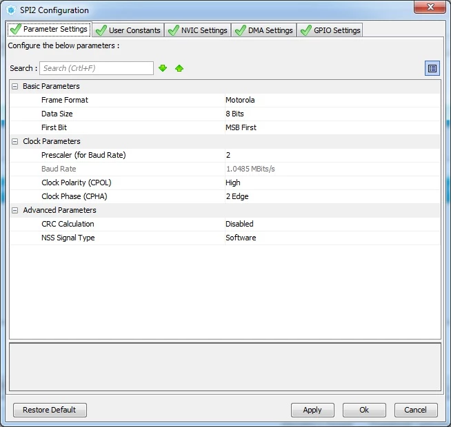

I have added FATfs(from MiddeWare). SD card has 2 GB capacity and it is SD type(not SDHC). It is connected to evalboard by sd adapter(like arduino). I have written power_on function, which you can see below. This function is called before infinite loop. I have expected 0x01 response but was 0xFF(I checked it by Logic analyzer). I don't know where is problem.
Hello everyone,
I have never used SD card in my previous project. Today I change it. I use STM32L053 MCU and CubeMX. SPI is configured in the following way:

Someone can help me?
Thank you in advance.
