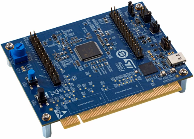

ZeST solution with higher output powers.
B-G473E-ZEST1S
Control Discovery kit
STEVAL-LVLP01
Power Discovery kit
ST offers a sensorless control solution featuring the ZeST (Zero Speed ​​Full Torque) algorithm, bundled with two Discovery kits: the B-G473E-ZEST1S Control Discovery kit and the STEVAL-LVLP01 Power Discovery kit. However, the power board has a relatively low output current (approximately 5 Arms). I would like to know if the ZeST algorithm can be implemented on a different power board that supports a higher output current.

Hello ​@Nguyen Hoc Vuong,
A low-voltage, high-current power board reference design, STDES-LVHP01, is available on the ST website. See the STDES-LVHP01 link.
If you agree with the answer, please accept it by clicking on 'Best answer'.Best regards.GMA
