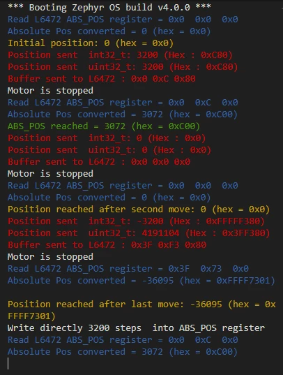

I'm working with L6472 (custom shield) with an NUCLEO-H563ZI under zephyr OS.
I'm facing out some issues with reading the register ABS_POS. I send  Goto command to the driver to move it from initial position 0 to position 3200. After the command is sent, the motor start moving to the good position but when I read ABS_POS register the driver send me the position 3072.
After multiple try, I notice that when the bit 7 (that represent 2^7 = 128) of the desired position is high the ABS_POS doesn't contains the correct value. Even if I write  directly on the ABS_POS, when I read data this is not the good value.
I attach my code and a screenshot to make sure you understand what I'm doing.Capture_UART.png

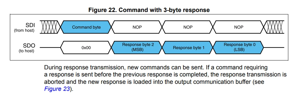

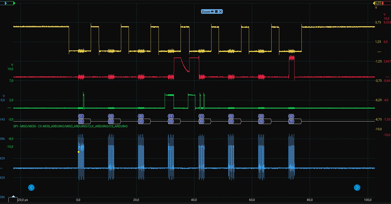

Feb 19, 2025 11:07 AM UTC
After trying different SPI configurations, I notice that when the default occured I have the L6472 trying to respond on the command byte 0x21 (corresponding to the read of the register ABS_POS), but it doesn't make sense with the datasheet.
Xavier-DiasysAuthorBest answer
Feb 20, 2025 9:46 AM UTC
I solved the problem, by just changing the GPIO mode of pins (MISO,MOSI,CS) to low speed.
