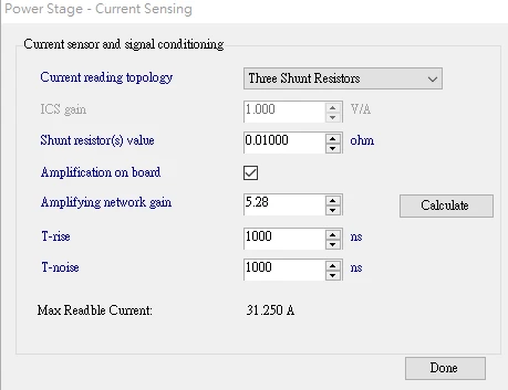

X-NUCLEO-IHM08M1 with NUCLEO-F746ZG can connect MCSDK warning overshoot current
Sorry this is my first time to use MCSDK, I am not sure what can I do.

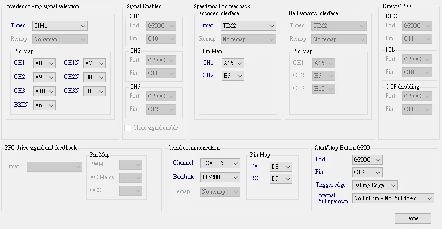

I follow Motor Profiler to set my board, and I check my pin map with my motor.
When I want to contorl my motor with MCSDK, it always warning over current.
I am not sure I have to set or edit what.

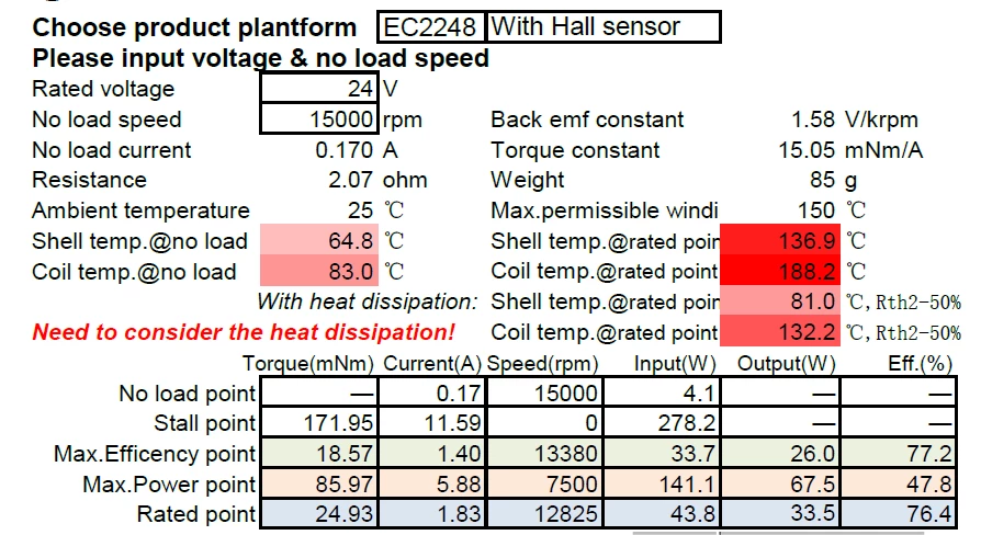

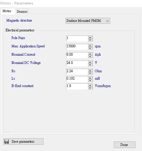

My motor Max current 10 Apk.

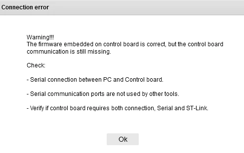

And I have another question, I can connect MCSDK ,but I try connect Motor Profiler warning.
It say control board communication is still missing. Do it effect my control speed accuracy?

My motor:
0693W00000BdcLTQAZ.pngIn the MCSDK I set value:
0693W00000BdcLiQAJ.png0693W00000BdcMCQAZ.png0693W00000BdcM7QAJ.png0693W00000BdcLxQAJ.pngHope you can help,

  • The motor profiler successfully profiled your motor , correct ?
  • The MCSDK does not spin your motor because you have an overcurrent error.
Board IHM08 exists in two flavors, Single shunt or Three shunts. The profiler works only with the three shunts version. (configuration is achieved with solder bridges).
Is your board configuration aligned with the one selected in the MCSDK ? (Three shunts if the profiler is OK)
"And I have another question, I can connect MCSDK ,but I try connect Motor Profiler warning.
It say control board communication is still missing. Do it effect my control speed accuracy?"
Sorry I do not understand what did you try to achieve. The usage of UART is exclusive, so you can not connect both in the same time MCSDK and profiler tool if it is what you tried to do.
Additional question. Your motor has Hall sensors. Did you configure the WB to make use of them ?

1. The motor profiler doesn't successfully.
When I click connect in motor profiler , it finally show this error.
0693W00000CzlTAQAZ.png​2. Yes, I click "start motor" or "Encoder Align" the motor run in a moment, and the Status Over current Light up.

By the way, sometimes the MCSDK connection board may fail, and I need to repeatedly press the button 2-3 times to connect. But I have used the STM32F407 board, but this is unlikely to happen.​
The motor has a Hall encoder, but it is damaged.
It also have a quadrature encoder, so the RPM is mainly obtained based on the quadrature encoder, and it can do in MCSDK.

Before going forward, you should check what is wrong with the Profiler connection.
Profiler requires the STLink connection in order to flash a dedicated firmware, and also the UART to send command to the board.
Are you sure that the boards you selected in the motor profiler tool are exactly the one you are using ?
