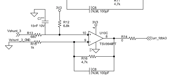

I’m working on a project where I am using the motor controller’s current sense circuitry (shunt + op amp). Here are my key details:
1. Hardware Setup:
- Board: X-NUCLEO-IHM08M1 with NUCLEO-H755ZI-Q
- Op Amp: TSV994
- Shunt Resistor: 0.01 Ω, 3 W rating (from BOM)
- Supply: 12 V, measured ~0.45 A from the power supply
2. Observations:
- At no load (no supply connected, only 3.3 V to the controller), the amplifier output is around 1.65–1.7 V, which I treat as the zero-current offset.
- When I measure actual load with the 12 V, 0.45 A supply, my code calculates 8–9 A from the ADC, which seems impossible because the supply is only delivering ~0.45 A total.
- I attempted to validate the amplifier gain using resistor ratios and the op amp datasheet. It suggests a total gain of around 13.7.
- I also used the approach of “maximum possible voltage” across the shunt (0.01 Ω) with a 3.3 V rail, concluding ~13–14× hardware gain.
- Yet, the measured “current” is far too high compared to the actual supply current.

so you use this circuit:
Offset is about 3v3 / (6k8+680) * 680 * 5.7 = 1.71 V ;
gain (1 + 4.7) = 5.7 ; and from input x / (6k8+680) *6k8 = 0.909 -> gain 5.18 ;
so 1A in the 10 mOhm = 10mV  -> * 5.18 + 1.71 = 1.762 V;
0.45A -> 1.733 V ;
So your zero offset is ~ 1.71 , measure it at start with no current , and use this as offset;
what you measure then from ADC, when having 0.45A in use ?

So what we have now :
- offset 1.7V  - ok.
- at 0.45A -> ADC shows 2.5V , real check on pin: 2.5V - right ?
- so whats real voltage at the 10 mOhm shunt ?
+ check shunt , if possible: is it still 10 mOhm ...or other value now ?
+ btw , is current measurement by ADC at shunt a static/continuous current, or is it pulsed ?
What you see on scope ? (show it...)
Hello Ascha.3
  • Offset voltage is correctly set to 1.7V.
  • At 0.45A, the ADC shows 2.5V, and a direct voltage measurement at the pin also confirms 2.5V.
Shunt resistor verification
  • Measured resistance with an RLC meter: 0.1Ω instead of the expected 0.01Ω.
  • Oscilloscope shows similar spikes on both sides of the shunt resistor, ranging from 60mV to 300mV.
  • Varying duty cycle (5% to 80%) only affects the amplitude of the spikes, but the voltage across the shunt remains unchanged.
Nature of ADC current measurement
  • Timer 1: 40% duty cycle at 2 kHz (PWM signal).
  • Timer 4: ARR value similar to Timer 1's duty cycle to trigger ADC callback.
  • Current measurement is expected to be pulsed rather than static.
Oscilloscope observations
  • Power supply: 12.2V, load draws 0.28A.
  • Similar spikes on both sides of the shunt resistor, ranging from 60mV to 300mV.
  • Varying duty cycle (5% to 80%) affects spike amplitude but not voltage.
