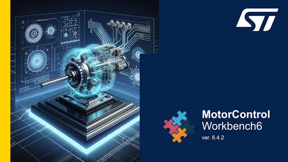

I started with the MC workbench and installed X-Cube-MCSDK Version 6.4.2. After installation the MC Workbench is opened, but the dialog is complete empty (except the caption). The behaviour is the same if i start the workbench via the desktop icon or as administrator.

This is how the dialog of the MC Workbench looks like. The popup window (MotorControl Workbench6 ver. 6.4.2) is open in the background.
CRoes.4
CRoes.4Author
Jun 23, 2026 6:08 AM UTC
The popup dialog is closed around 30s after starting, but the MC Workbench dialog keeps the same all the time.
